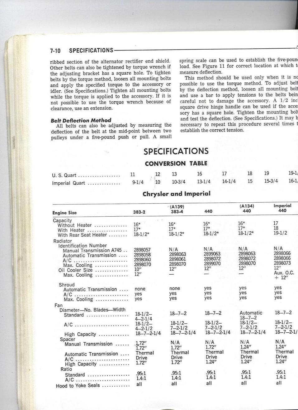

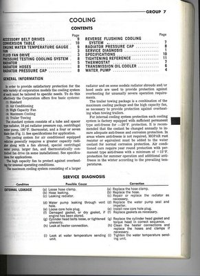

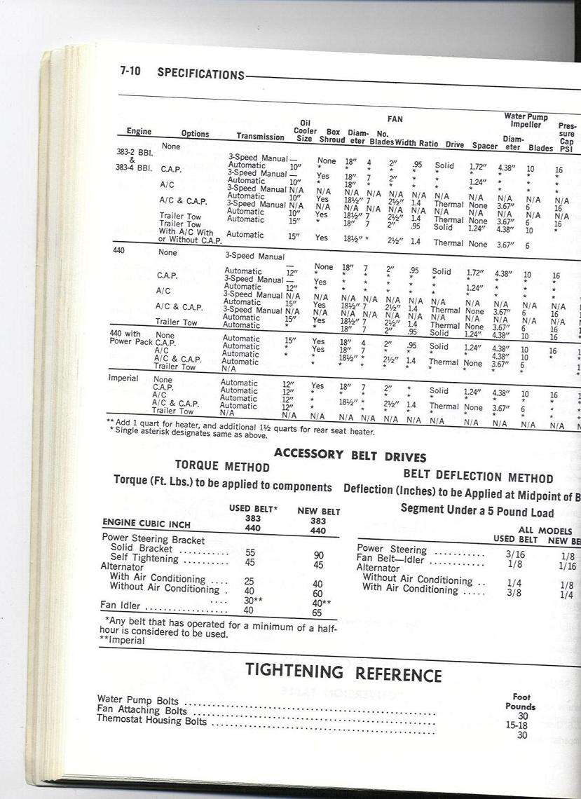

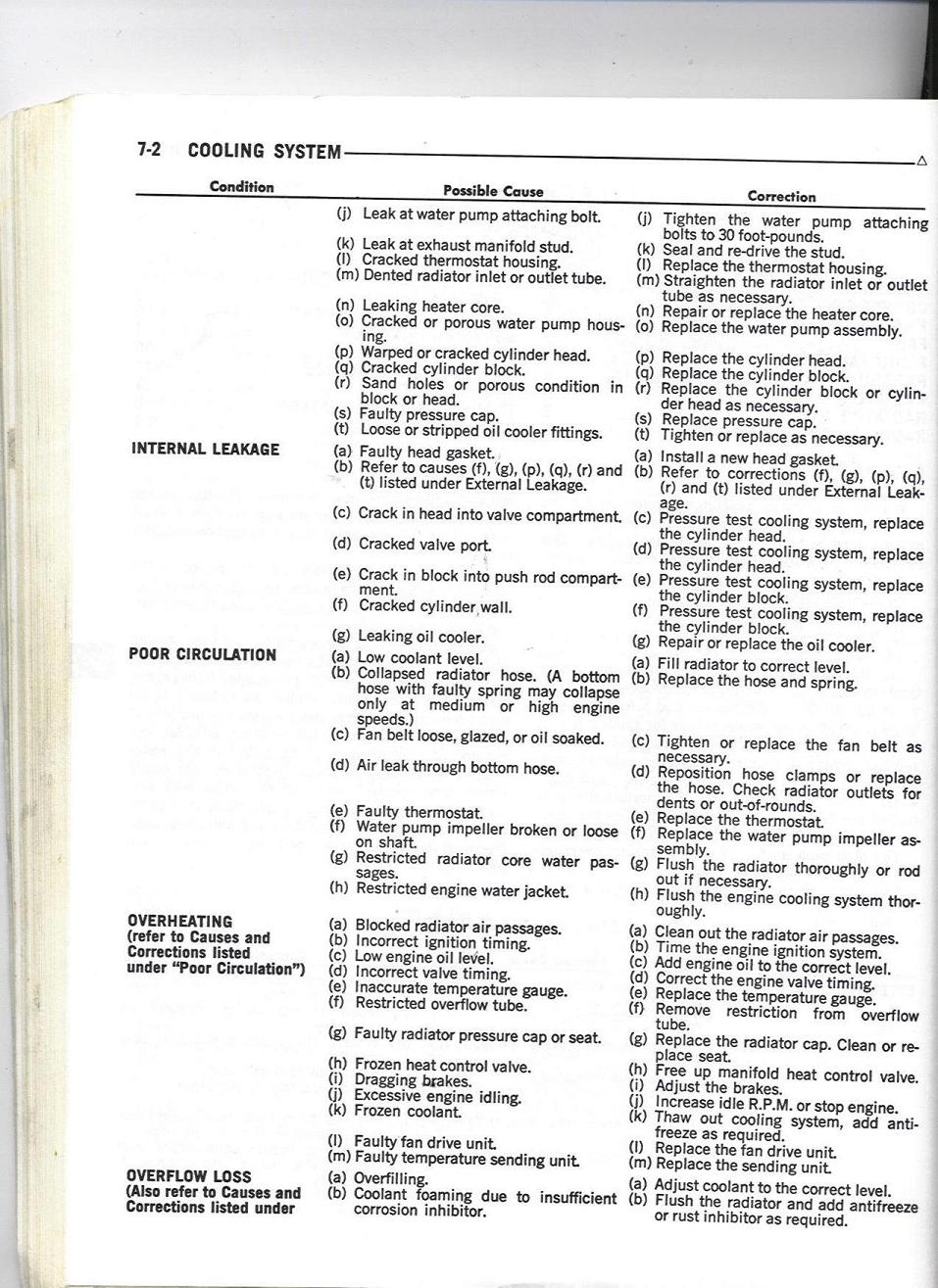

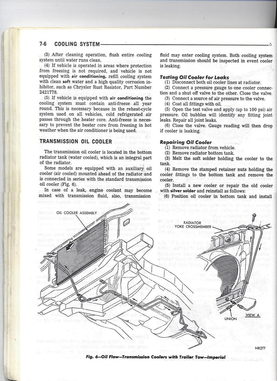

Here is direct from a era MoPar Factory Service Manual ( FSM ) and
the printed information in it.
It does not address the problems of the electric cooling fan when
added on an vehicle and the person does not understand the total
cooling ( or electrical ) picture since when it was printed the
electric cooling fan was not yet sold to the "know nots".
By about 1979'ish MoPar no longer used a hard mounted four
paddle cooling fan. Every Dodge Truck, Dodge Rear Drive Van
and all MoPar F-J and M cars were using the Silicone Fan Drive
with a five paddle Cooling Fan on light duty vehicle's and a
seven Paddle unit on HD versions.
Nor does it address the use of over sized ( diameter ) tyres
and what it does to the cooling ( or drive train ) system.
Again re-read what can cause the over-heating and find out
how to prevent it.
Rodger & Gabby
COS
how to prevent it.

Re: Radiators
I am going from memory on the cap, 14-16 pounds.
Typically Chrysler recommended a 195 degree thermostat on almost
all V-8s. However, 180 is what most people will tell you to run, myself included.
Water Wetter is good stuff, it help my 440 out nicely till I got the new radiator.
Distilled water is HIGHLY recommended in all radiators! Also, when draining, pull
the plugs in the block to completely drain the water jackets. Otherwise you still
leave a couple gallons in the block when just draining at the radiator. Also pull
a heater hose to allow air to get in around the closed thermostat.
