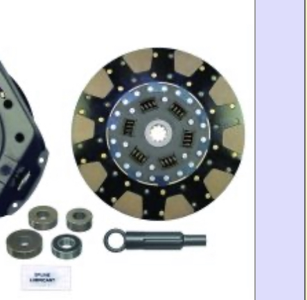

I put a 68 d500 435 into a 66 d300 behind a slant 6. The input diameter did step up to 1.375” from 1”. There was a few things we had to do.
1. I was able to find a clutch disk from a 64 f-250 that was 11” with a 10 spline 1-3/8” input shaft. This took a handful of trips to the parts store to source. It has to have the 6 smaller springs around the hub and not the 5 larger. See images below. We had a diaphragm style pressure plate originally and when the levers would release the pressure plate they would hit the 5 larger springs. Our original clutch was a 6 spring style. If you have a Borg and Beck (lever) style pressure plate it might clear the 5 spring. I was able to find this at Napa.
2. Due to slight differences in the offsets of the hub of the clutch disk, we had to remove a small amount from the end of the input shaft bearing retainer for clearance. If I remember correctly it was something like 1/4”-3/8”. We did this in a lathe but it could easily be done with a cut off wheel.
3. We used the larger parking brake assembly that was on the larger trans. The yoke saddle for the u-joint just unbolted from the smaller trans and bolted directly on the larger trans parking brake assembly. This allowed us to use our exist driveshafts and joints.
It’s been in the truck for a few years now with no issues.
