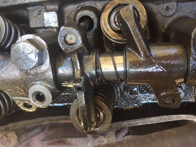

Here is a picture of the rockers for reference.
Re: Poly 318 Hydraulic Cam/Lifters
Is the engine a 318-3 premium engine?
Posts: 7529
The pic answers the question. U must pull the manifold off to remove the lifter. U could swap on an adjustable rocker and leave the lifter as is.
