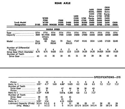

kurt, you seem like someone who would be able to answer this for me. i have a stock dana 70 LD on my truck, 10 bolt. how much gear oil do you think it would take to fill it up? those squeeze bottles is what im referring to. and what weight would you use?

Jake66 wrote:kurt, you seem like someone who would be able to answer this for me. i have a stock dana 70 LD on my truck, 10 bolt. how much gear oil do you think it would take to fill it up? those squeeze bottles is what im referring to. and what weight would you use?
Actually I have no idea. This pic is from a 1968 service manual it says 6 pints. I googled dana 70 and the newer ones take 7 pints.
