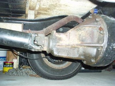

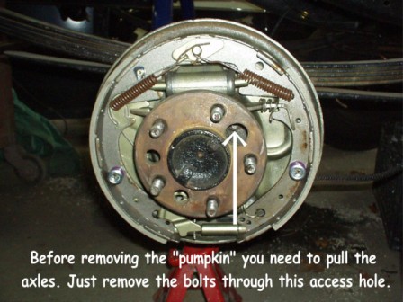

You can even use a "Pumpkin" out of a car that has the 8.75 rear in it. They are the easiest to change out too. Jack up rear end of truck, remove both rear tires, remove the driveshaft, Remove brake drum and you will see a HOLE in the hub of the rear axle. Remove the 4 or 5 bolts that line up with that hole. Those hold the axles in. After you removed those bolts, slide the axle out a few inches. Remove all the bolts around the rear pumpkin and then it will pull out. OH.... drain that nasty smelling gear oil before removing the pumpkin. There are no drain plugs. You need to loosen the bolts and let it run out into a pan. After it finishes draining, remove all the nuts from the pumpkin and pull it off the FRONT of the rear. They are easy to do... just reverse the procedure to install it. OH... buy a new gasket too. Most likely NAPA would have them.
Hope that helps!
