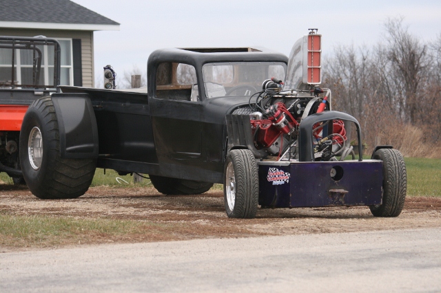

I have talked to 30+ different yards/rebuilders and the h140 is a real rear. No one can tell me what it came in because rockwell rears were used in so many different things. That is why I came on this forum to ask you guys who have these trucks. Which I love this body style of truck. My next project is a sweptline 4wd.I did find a few ring and pinion sets thru my diging but new was any where from $2800 to $4300. I finally just bought a used cener from A&A truck salvage in NJ. They are the same guy's with the pile of F106's on ebay. I know a couple of puller's that have bought from them before and were happy with there purchase.Thanks for the help guys. I have been really impressed with the help this site has given me. Thanks again
