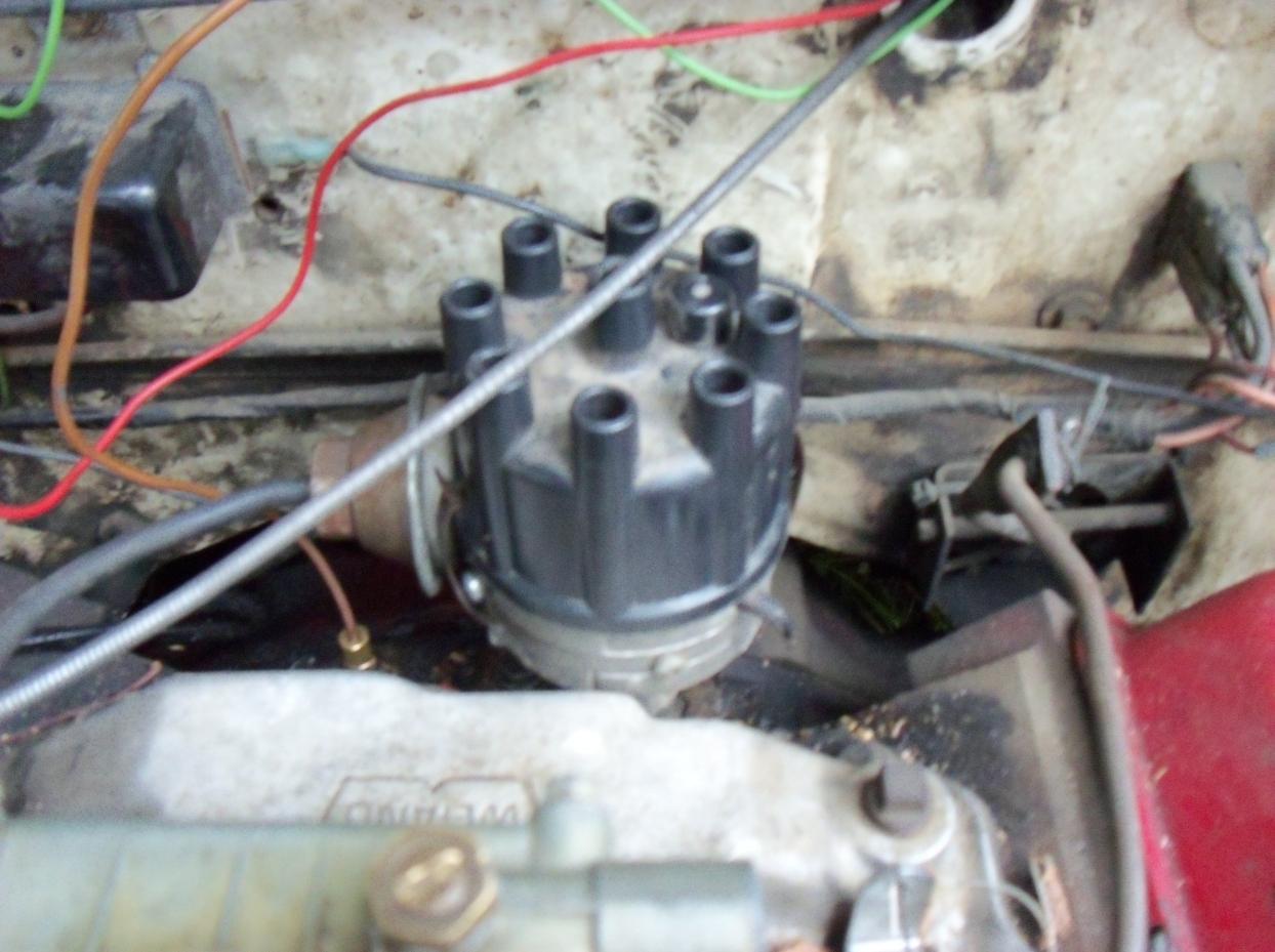

@Hobcobble We set the valve lash when we first got the truck, and to get tdc don't you just stick a screwdriver down the spark plug hole and wait for it to stop going up?

Nope, that may result in being 180 out.
TDC needs both the intake and exhaust valves closed. The exhuast stroke will have the exhaust open and not develop a pressure. You want to be on the compression stroke.
Backyard method would be to put a finger over the spark plug hole and turn the engine. (not with the starter).
When the air pressure pushes against your finger, you are on the compression stroke. The you can use the screwdriver idea.

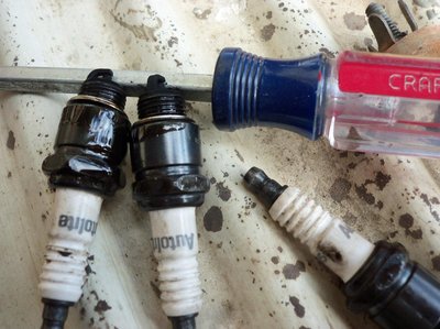

^ Is somewhat how it went... "take a look at the pic" yes i know its running real rich but its not like i drive it. Oh and to top the day off one of are dogs got fleas from the damn neighbor dogs! :clap
And when you say 180 out what part are you talkin about? the rotor or something?

66sportfury wrote:And when you say 180 out what part are you talkin about? the rotor or something?
Yes, he means distributor is installed 180 degrees out.
Those plugs look like it is running rich to me, or oil is getting passed the rings. In fact, is that oil on the plug itself?

sorry about the late response but yes that was oil #1 had oil and #2 had alittle...sigh it seems whenever your plan on doing something it always gets screwed up. Just wanted to sell it to pay back my brother for the power wagon, and have already spent over 200 trying to get this thing back to the state it was when i first got it running lol

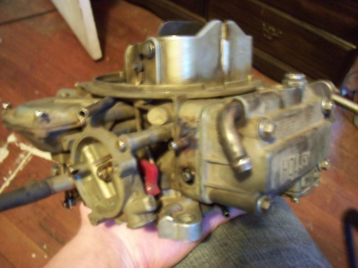

Also I'm putting on the new holley, new spark plugs, and 3 new wires today maybe even the exhaust. Which was at My moms friends house, cause when she sold him "the beast" she gave my exhaust that i cut off my truck to him :shame
So me and my brother just went over there and kind ah umm hopped there fence and grabbed it than hauled :censored
The pic is the new carb but it has a Horrible Electric choke, So i was wondering if its possible to run it without the rest of it? "what ever is missing" sorry but i don't know electric chokes, I'm a real man and i like just about everything manual
Last thing yes i realize this is alot to read but on the 4150's when you take the screw out of the bowl it shouldn't pour gas out unless you shake the truck right? Cause my front bowl i couldn't get fuel to spill out, i heard it though. Would that be the culprit for it running rich? or does black plugs mean its runnin lean? im confusing myself
Isn't the way it should be?

An electric to manual conversion for the 4150 is available from Holley: CHOKE CONVERSION KIT PART #: 45-225. Or you could get a full electric kit.
Unfortunately for my odd-ball Holley, no conversion kit is available so I use the hard-core manual method: open hood and twist tie when choke is necessary. :lol:
Here is a great NGK link for reading spark plugs. At first glance it looks like the 'Dry and Wet Fouling' case to me. I'm worried about the oil on the plug itself. Like the rings aren't sealing. I could be wrong. Can you do a compression test?

No, I didnt mean the distibutro is installed 180 degres out.
What I said was that if you just use a screwdriver and stop when it is pushed up the most, (Like you asked about) you may be at TDC of the EXHAUST stroke vice the compression stroke.
If you treated that as TDC compression, you would be timing the engine 180 degrees out.
