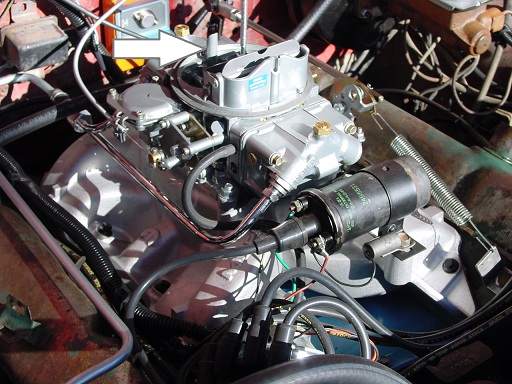

fuel pouring out of the secondary vent tube while the engine is
running?
As some of you might recall from my post I installed this carb and
intake a couple of weeks ago, I finally drove the truck Saturday after
installing the new wheels, tires, and bumper. Sunday morning I
took it to breakfast and a short drive afterwards and then parked
it. Monday after work I wanted to take it to the post office to drop
a package, She ran but you could tell she was loading up so I reved it to
clean it out but would never clean out? after I shut it off I then saw
the pool of fuel on the intake runners, I mopped it up pulled the air
cleaner and cranked to find the fuel pouring out of the vent tube (see arrow)
This doesn't eliminate trash in the fuel however I'll mention it anyways:
New:
Fuel Pump
Fuel Filter
Fuel Lines (rubber and hardlines)
Fuel tank cleaned.
It is a dual feed carb but Not a Dbl pumper!
Thank you for any and all info/tips/suggestions
