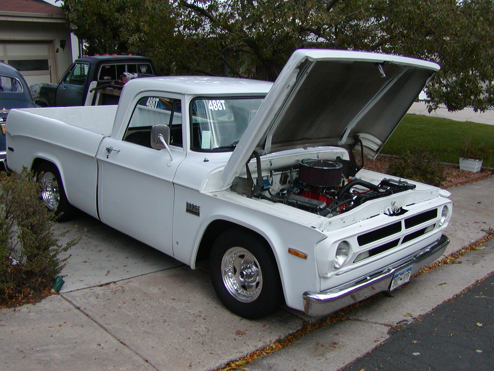

Re: Stroker?!
this is s daily driver
this is etsweptsters truck this year his times have been around the 11.50's with no additives, but its now on E85, its his primary source of transportation, its alot more than just stroked :Thumbsup
