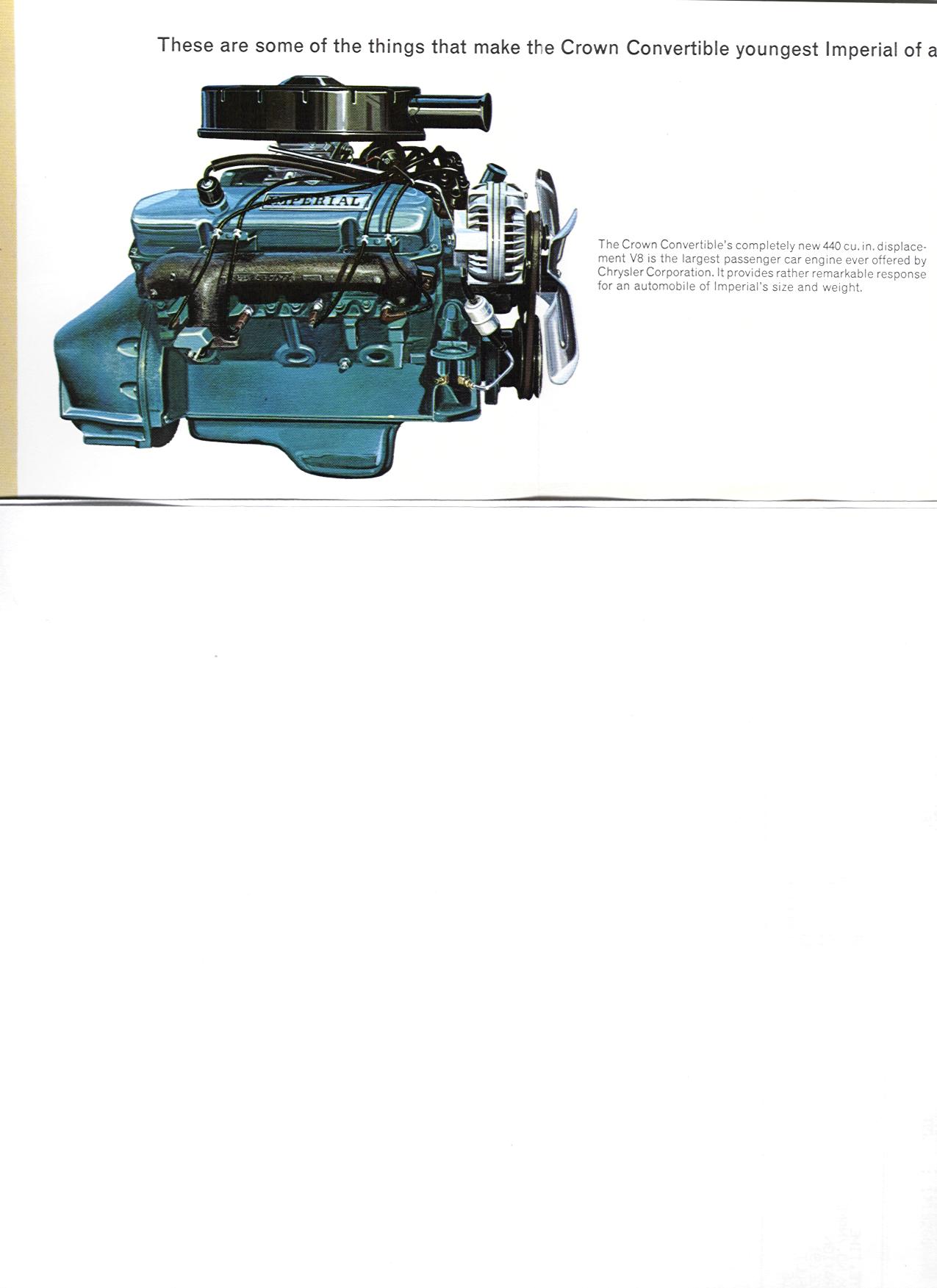

Re: Front Sump or Rear Sump
Sir
This is a 1966 440 from/for the Imperial Division.
Rodger & Gabby
COS
