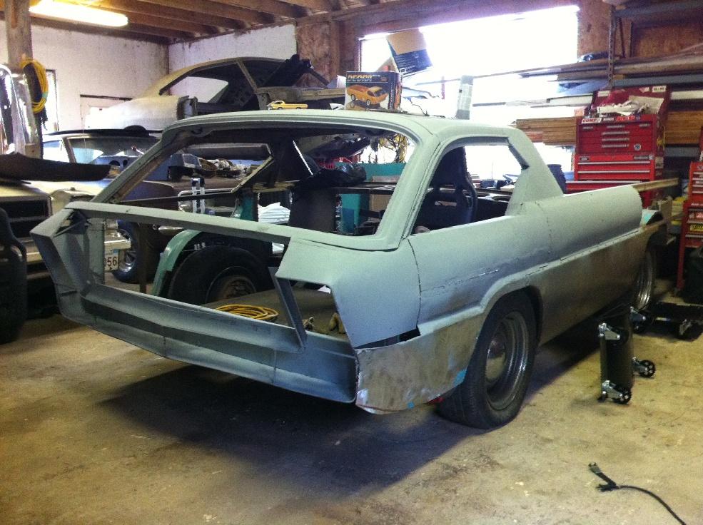

I'd considered adding the Toyota LE rack and pinion to my Deora (A108) straight axle. This set-up seems like a fairly good idea, and the Toyota also provides a 90-degree gearbox to change the steering input direction back to the proper alignment for the steering.
On the surface, it sounded like a good idea.
For my project however, I soon realized that it would mean putting the steering box directly in front of the driver was the absolute wrong thing, as the Deora has a front-entrance, and having anything to impede entering/exiting just complicates things.
As far as adapting this to an A100 (or D100), I don't think it's a bad idea per-se. Mounts would have to be fabricated (welded) on the axle itself to hold the rack. Not impossible.
The thing you'd have to contend with eventually would be the movement of the axle, with relation to the steering column. I'd considered buying a Flaming River steering column with a sliding shaft to account for the action.
Meanwhile, I got an S15 power box that does the trick for me, and puts everything in the right spot for entrance, so I'm happy with the results. How that could translate to a stock D100 or A100 is going to be somebody else's post here I guess!
Oh, and by the way...the Deora is coming along quite well! (So all that cutting of the original van wasn't a wasted effort!)![Laughing :lol:](./images/smilies/icon_lol.gif)
