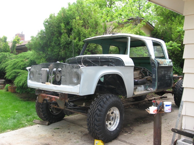

These are the tallest sweptlines I've seen, besides old school monster trucks... lets see some pics of your project

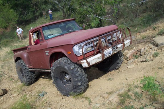

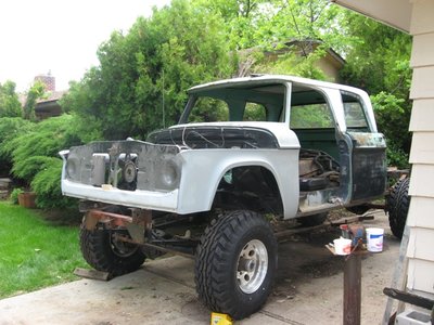

Here's the only picture I have of mine. It isn't that tall, compared to some of the other pictures.
As far as the rear suspension, I plan on doing front drop brackets, and a rear shackle flip. The goal is to match the front with no blocks.

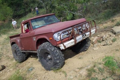

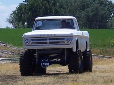

Here's an old school monster truck and one on 44s.
Don

crusty wrote:Here's the only picture I have of mine. It isn't that tall, compared to some of the other pictures.
I think you're full of it Crusty. :lol: Just for reference, those are 37" HumVee tires everyone. That crew is standing nice and tall. :Thumbsup I don't recall what you said the height of the rockers were, but IIRC, your truck was nearly a foot taller than my stocker. Probably about as high as you would want to go if you really used your truck. Any higher and it's impractical to haul or tow, and a little top heavy for wheeling in anything other than a mud pit. :2cents

Aww you guys are going to make me blush :lol: I gotta say, it is nice to know that people like what I am doing. Anyway, here's some measurements from my truck. The bottom of the frame to the axle tube is about 15.5" and the front spring eye is mounted 6" below the frame. Also, the rear shackles measure 6" from eye to eye.
This might be about 8" over stock???
The reason I redid all this was that the bent up factory crossmember seemed flimsy, and I wanted to do crossover steering. I figured that doing a shackle reversal at this time would be good as well. My crossmember is 3" 0.25" wall and the side mounts are 3" channel. Hope this helps anybody who is looking to do something similar.

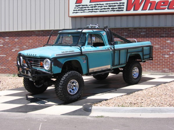

how about this

redrider wrote:how about this
NICE!

Who ever built the cage for that truck should have their welder taken away from them :shame
Re: Tallest Powerwagon pictures anybody??
should be limited to working with wood!

Never exotube a powerwagon. like the truck isnt tough enough with its heavy body steel.

ricknadine1111 wrote:Never exotube a powerwagon. like the truck isnt tough enough with its heavy body steel.
Haha going to be doing an exo on mine....Dont want to waste good fenders now.
