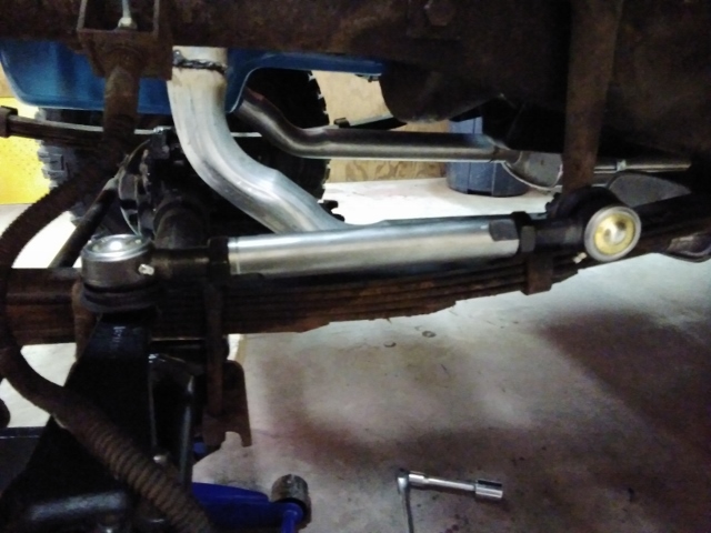

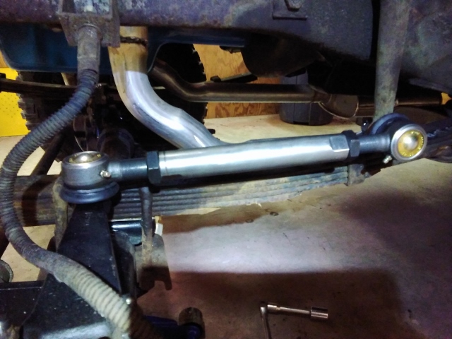

Well after that debacle I found a place that custom makes drag links
https://www.wfoconcepts.com/pr/Custom-1 ... /4295/3707
All they needed is the center to center length and the type of tie rod end you want. $233 with ends and lock nuts.
I used Moog ES 2010R & ES2010L which are available if I ever need to replace them.
The only issue I had is the tapered section of the tie rod is bigger than the factory. This was solved by slowly boring the holes out with a 7* tapered reamer.

Just to clarify. I did the reaming by hand with a tap handle, actually didnt take long at all. I didnt measure the before and after but Id bet I didnt take more than 1/16" of material out.
The real issue was the new end didnt go far enough in for the cotter pin to fit through the castle nut. Thus the need to ream. I probably could have found a shallower castle nut, but this is the better solution in my opinion.
One of the benefits is that I now have full turn stop to stop. Before this I couldnt get all the way to one side.
I just wanted everyone to know there is a source for new drag-links out there.
