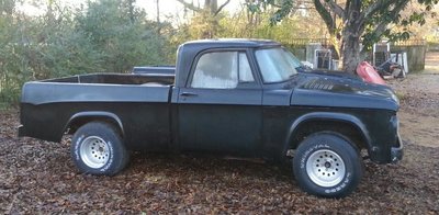

Here it is... I'll post more shortly.

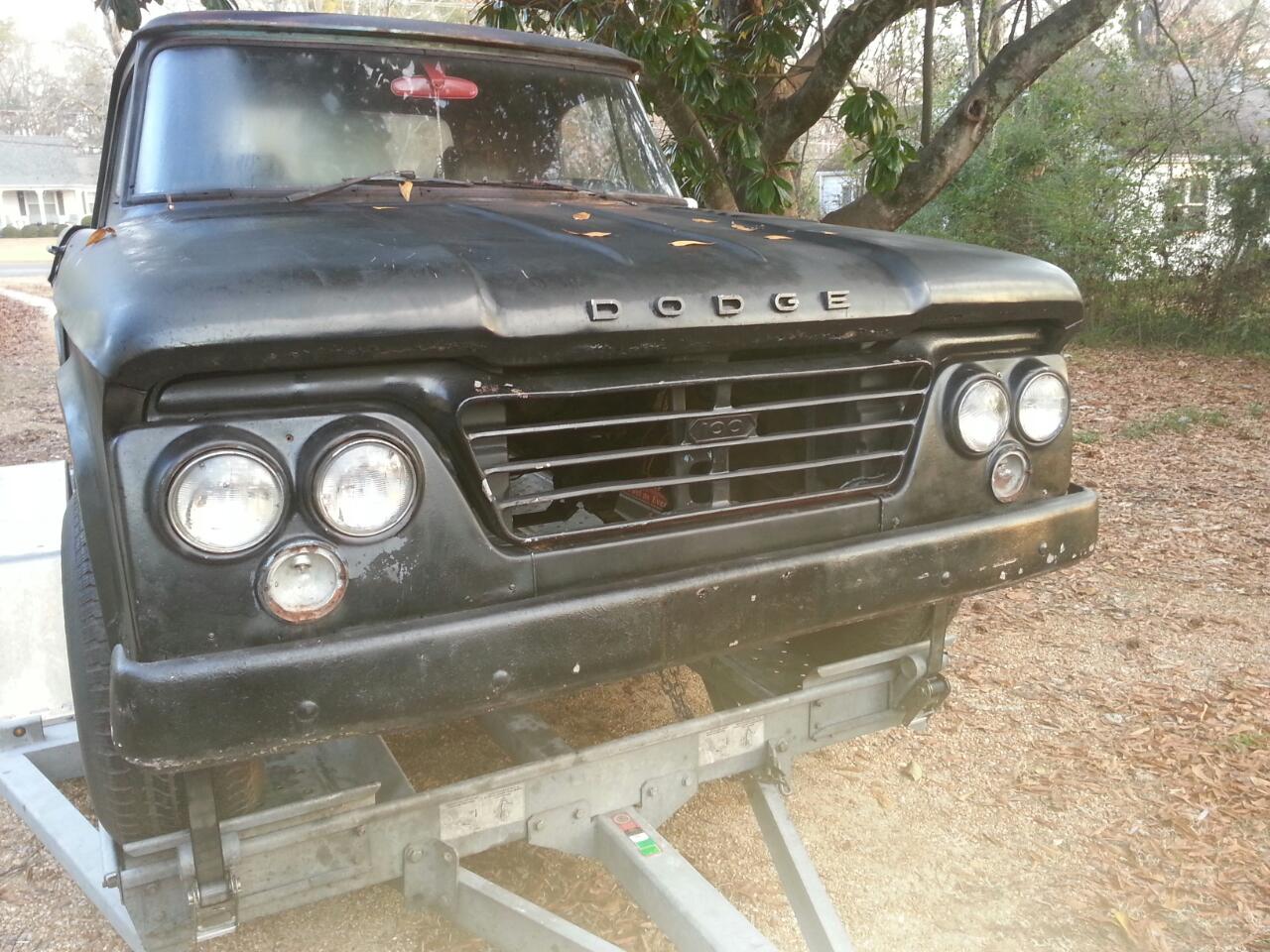

Love the front of this thing

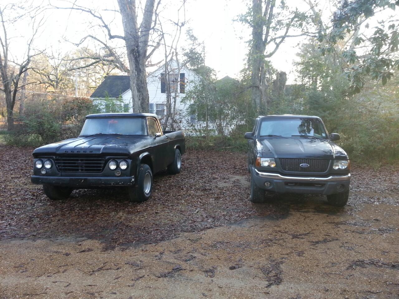

Future transportation... vs... existing transportation.

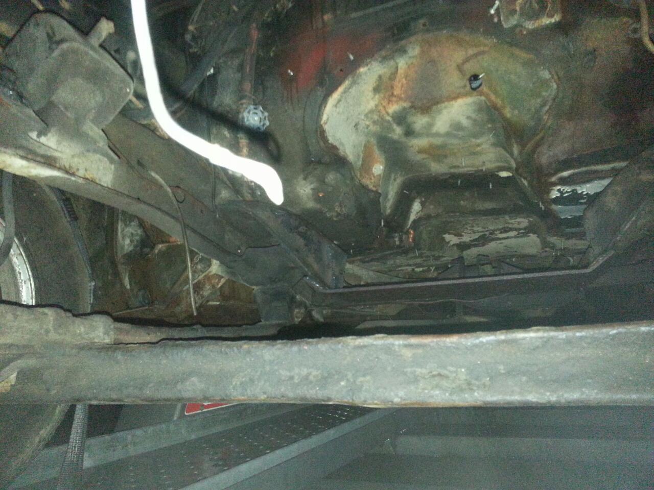

This truck was originally a slant-6 with 3 speed on column. At some point in time it was converted to a 318 with automatic. The owner before me pulled the engine and transmission and had ideas of making it a street rod with an LS1.
This photo tells you a lot.... the cross member was cut for the automatic transmission. Still not sure how I feel about that... motor mounts are in place for a sb v8 (318/360)... but at this point in time, I think that is kind of irrelevant.

Re: 64 D100... what to do...
Dodge did that from the factory on 61-68 automatic trucks. They cut the crossmember and built a spanner. Many people think it looks like something a previous owner did. Yours looks as good, if not better than what Dodge did from the factory.Gigabitdrew wrote:This photo tells you a lot.... the cross member was cut for the automatic transmission. Still not sure how I feel about that...
Really?!?! Who would have thought that? That's good to know.soopernaut wrote:Dodge did that from the factory on 61-68 automatic trucks. They cut the crossmember and built a spanner. Many people think it looks like something a previous owner did. Yours looks as good, if not better than what Dodge did from the factory.
