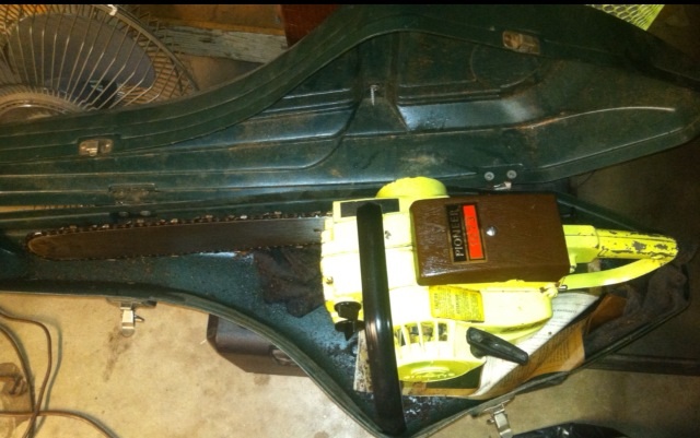

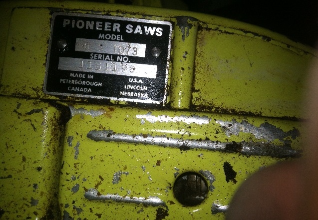

Here's some pics. Sorry it took so long. I'm down to 1 day a week with this gentleman.

Looks like a model 1073 and also maybe that is a 16" bar?? :Thumbsup Thanks for posting the pics!! NICE case too!

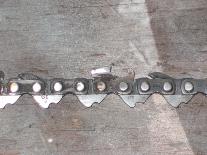

Turns out that the Oregon Chains do NOT fit my saw. I tried the H72 for the 18" bar and that was a little too long. Then, I looked closer at the bar and seen it had a 16 on it. So... I figured it was a 16" bar. So, I ordered a H66 chain and guess what.... too short!! I counted the drive links and found that mine has 69 DL on the chain. :banghead Nothing is easy.... Seems OREGON does NOT make a chain for MY saw. I DON'T really want to order one online as then if it is wrong, i have to pay shipping to return it. So, I had bought the last two from Lowes for ease of returns (just in case). I guess I can take it to a mower shop. We don't really have Logging supply places around here in NJ.

After I posted on here yesterday (but before I read your post) I found on the OREGON website that "some" Pioneer bars have been found to have chains with 69 Drive Links.
It says: Count drive links on 16" - several cases with 68-69 dl (poss 17" bar) That was the FIRST time I seen THAT page!
http://www.oregonproducts.com/pro/looku ... LangId=ENG
I went to the LOGGERCHAIN.COM site and they specifically show a chain that has 69 drive links, .325 chain and .050 bar! So... I will contact them and see what happens. THANKS for that link!! Looks like this LOW KICKBACK chain is the one I would use: 20BPX069G Oregon 18" chain .325 pitch .050 gauge 69 DL

John, I did go to http://www.loggerchain.com/ and ordered a 21BPX069G which is the Low Kickback type. My original Pioneer bar says: 16-058-325 and the ORIGINAL chain has 69 Drive Links and most links are still "readable" and each have 58 325 stamped on the links. The center cutting link in the photo you can "almost" make out the word PIONEER on the link... but it doesn't show up too good here in this post due to me "shrinking" it for the website. THIS 21BPX069G chain I got and it fit my old Pioneer perfectly!! JUST LIKE NEW!! Nope... haven't cut any wood yet, but I'm READY! :clap
NOTE: Loggerchain.com claim this is for an 18" bar! :thinking
