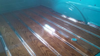

FYI, I have successfully installed the LMC under the bed gas tank kit for a 63-66 chevy in my 65 d100 short bed. I had to move the aft crossmember back 5 inches to make room, this is not that hard of a task, this crossmember is rivet in and the lower hole when you move it aft is already drilled in the frame.

Every photo I try to post says it's too large to upload the file. The filler is in the bed, with a pop-up filler tube that will be in the bed, Bed is not back on the truck yet If you want photos send me a private message and I will send you some.

here are some photos of the truck with the tank installed

tank can't be seen

tank

very, very nice...Now, what is the clearance between the top of the FRONT of the bed and the bottom of the window? I need to get my bed laying perfect...

I have about 2-3 inches of clearance between the top of the tank and the bottom of the bed

I struggled to get my bed/cab alignment correct. I added spacers to the cab side to get correct. There is no adjustment on the bed blocks,
