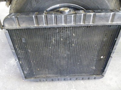

Here are some pictures of the radiator. Jim

Do you guys know if a 26" radiator will fit in the same radiator support as the 22" that is currently in my truck?
nytemuvr
Posts: 915
City: Rio Linda
Re: 1970 W100 Radiator P/N?
Post by nytemuvr »
Jeremiah wrote:Do you guys know if a 26" radiator will fit in the same radiator support as the 22" that is currently in my truck?
There should be a model number by the filler neck with the Mopar number that references the radiator(Modine). If not, it may be another brand. The 26" I don't think would fit, the yoke hole isn't that wide. At least that's the way they did it with cars. 22" and 26" used different radiator yoke supports. I'm more familiar with cars, still learning about these trucks.
