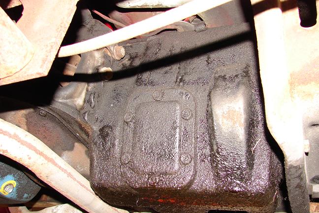

On another note it looks like the transmission isn't an NP435 either. From what I can tell it's an NP445 (or NP4530 or what ever you want to call it). Here's a shot of the left side of the transmission. I have two exhaust pipes going along the right side of the tranny so I can't get a good view of it from the right side.

The 445 trans is synchro in all 4 gears which is really sweet. I have downshifted into 1st as high as 35mph with no grind. However, it is a close spaced ratio trans with 1st at 4.56:1. Not the granny low of 6:1. On the downside, as a true 4 speed, u will usually have to start in first, rather than second. On the upside, third is higher and u can shift into 4th at 60+ with a 4:10 rear. All this makes driving the W100 383 SWB a blast.
