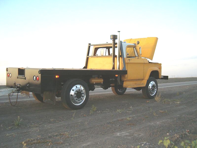

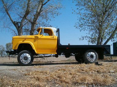

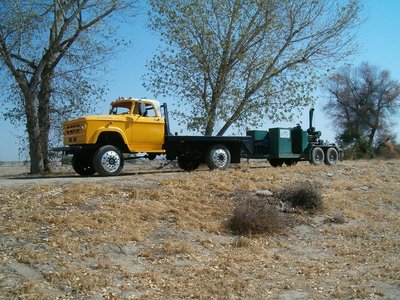

I'm REALLY hoping the oilfields are going to pick up here soon I've been pounding on the old Mc Mobile while I have LOTS of free time.
Hooked it up to my tong trailer that weights 9,200lbs. and took it for a test tug. With 60 forward gears and 12 reverse I was finally able to find the correct gear :thinking . I spent more time shifting and than driving LoL. Just what I wanted for a weekend worrier.
Driving without front or rear glass it hard to hear any problems but she felt pretty solid (note, don't open mouth at speeds :shame ). With this being my 2nd rebuild I really tried to take my time and do things right, but I'm sure some bugs will be popping up.
Thanks

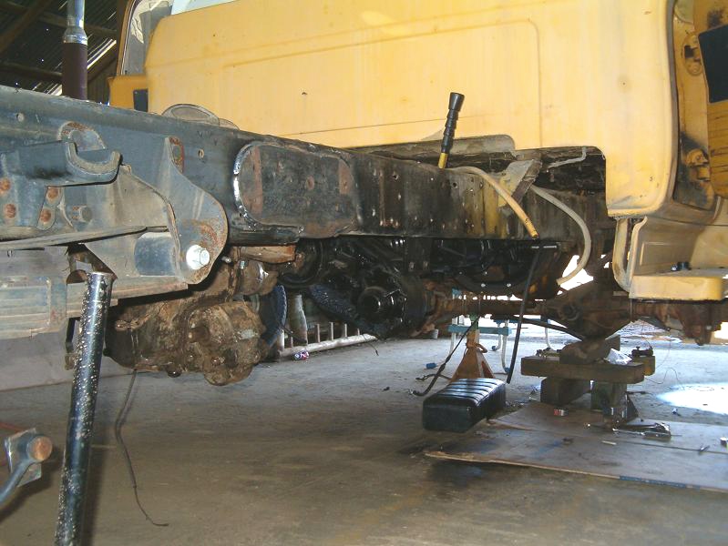

Pat, I bought a wrecked 2wd '01F350 chassis for $1,500. Cut the back half off and mated it to the W. This allowed me to lengthen the wheel base so I can fit the extra tranny in. It also made my life so much easier having the Ferd fuel cell, shocks, sway bar, disc brakes, and emergency brake all ready to go. The other big benefit was getting rid of the 4:88 gears. Now I'm running 3:73 in the back and '78 GM 1 ton axle up front with 4:10 gears. The other benefit was getting the power steering box and hydro booster, scrapped everything else.
Regarding 10 lug wheels, using the rpm calculator I needed about a 36" tall tire for the gear ratio to work out. With me getting old (mid 40's) I didn't want noisy Super Swampers. Especially with how heavy this truck is it would have made toooo much noise.
A company on line makes 8 - 10 lug adaptors, this solved the tire rotating problem with having metric 8 lug in the rear and standard 8 lug up front. So I bought the adapters for about $150 each and new tires and wheels. Cost about the same as Super Swampers with Weld wheels and I wouldn't be able to rotate the tires with 2 different lug patterns. Now the outer 10 lug pattern is the same. I also really like the nice smooth quiet truck tires plus it has a distinct look :Thumbsup . My buddy has been trying to talk me into turning the back rim around and putting duals in the back. But I'm afraid it will ride to rough with 4 heavy duty tires across the rear.
Re: Happy, Happy, Happy :)
MikeMc wrote: Now I'm running 3:73 in the back and '78 GM 1 ton axle up front with 4:10 gears.
Shouldn't you be running 3.73's up front then? :thinking

Good eye Hob, while out playing around I got stuck in the sand so I put it in 4x4 just to get out. Only went about 10' and the drive train was bound up and I could hardly get it out of 4x4. Until work pics back up :2cents the 4:10's are there to stay.

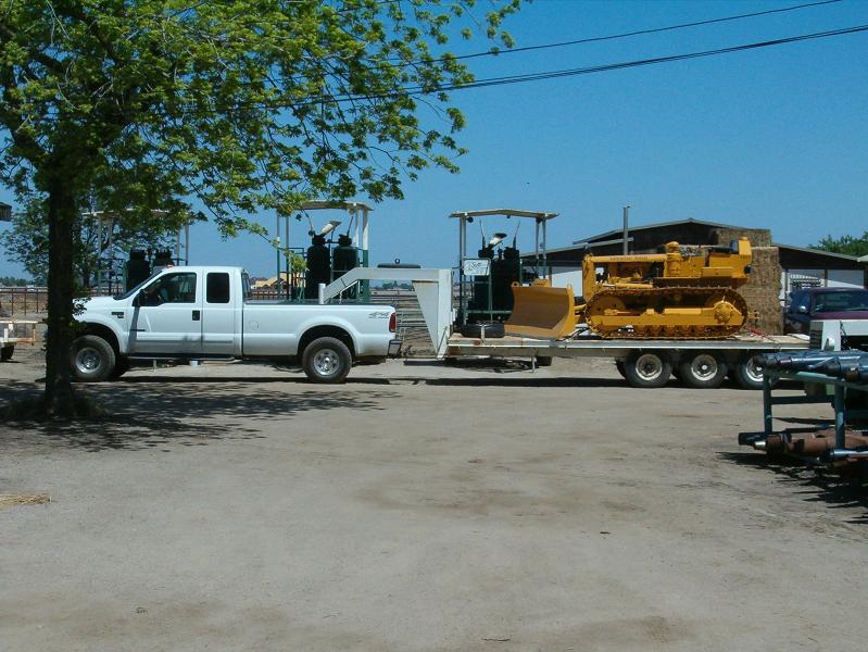

dwh, D8 weights 48K so not even going to try but I plan on hauling my D4 with it. I'm currently using my F350 and tips the scale at 28,800lbs. and the W weights about 2K more than the Ferd. Heck no I don't stop at the scales LoL

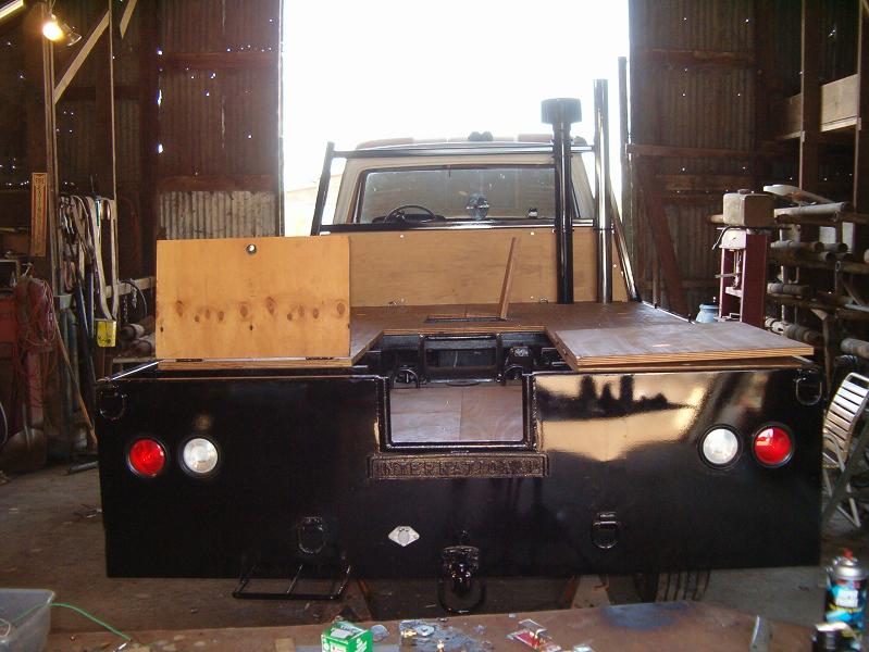

I don't remember were I got the adaptors but if you type "8 lug 10 lug adaptors" into google several sites will pop up. I had the adaptor company make 4" spacers so the back wheels are the same width as the front. If I decided to turn the rear wheels around or run duals the spacers can be unbolted.
That was my initial plan to put super singles on the rear. After trying to pick one up and seeing the 12-13K weight rating per tire I quickly realized this heavy tire would rob HP and suk up fuel. Even with the heavy flat bed I built and wicked winch installed over the rear axle the stiff side walls would give a terrible ride. Also seeing the price per tire $400+- not including the high dollar wheels :pale . The other negative is they don't make a low pro in the S.S. so the tires are close to 40" tall.
Although it would look bad @#%! But I wouldn't get them for a pick up.
