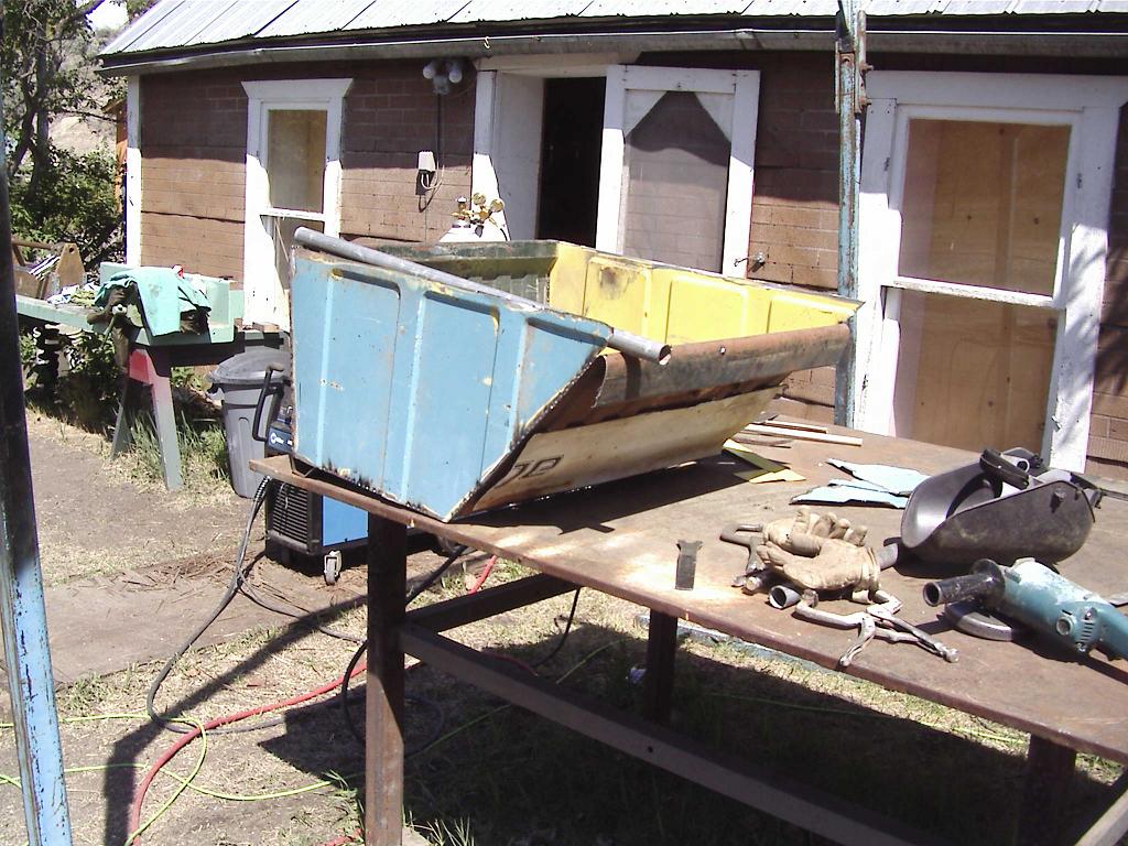

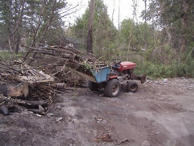

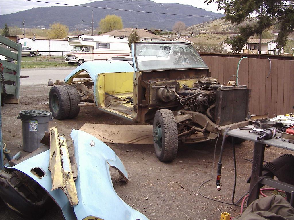

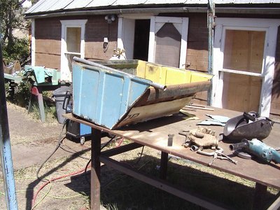

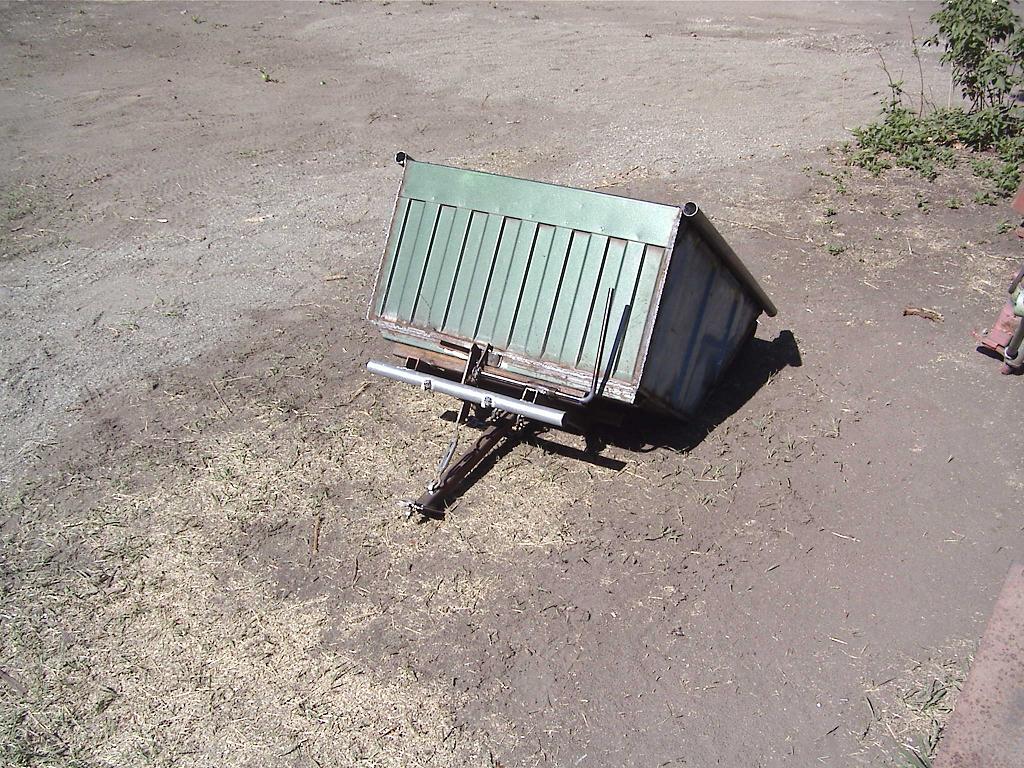

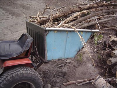

don't mean to hijack your thread, but those old body parts are plenty handy... and the new wire feeders make it so incredibly easy to work with this stuff.
this was a rock box project for my little mf10, it's certainly nothing fancy, but it works. and there is still plenty of steel left over from the cab i cut up and no doubt plenty of it will eventually end up in place of the rust on my d300.
have fun and remember, those zipcuts are sharp and safety glasses are a lot less hassle than having a rust ring cut out. :Thumbsup
a plasma cutter sure makes short work of cutting one of these cabs up
the sides were from the back of the cab, the box front and floor from the box front section of a 78, and the center section of the tailgate from the same 78. tubing comes from a neighbours (old) fence ;)
basic 3 point type hitch
no point having to unload a rock... a dump works way better
