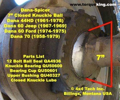

Can you post some photos of your front axle? I'd like to see
the knuckles and the tie rod in particular.

Dana 44, 3500lb axle with 7" ball. Tie rod is 3/4" fine thread. Not a very good picture but I may be able to get more soon.
