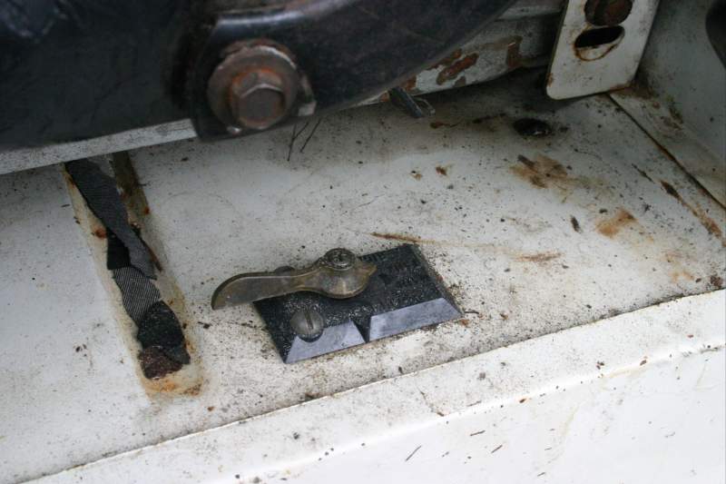

It is a valve on the floor, not a switch. Follow the lines that are connected to it to figure out where they go.

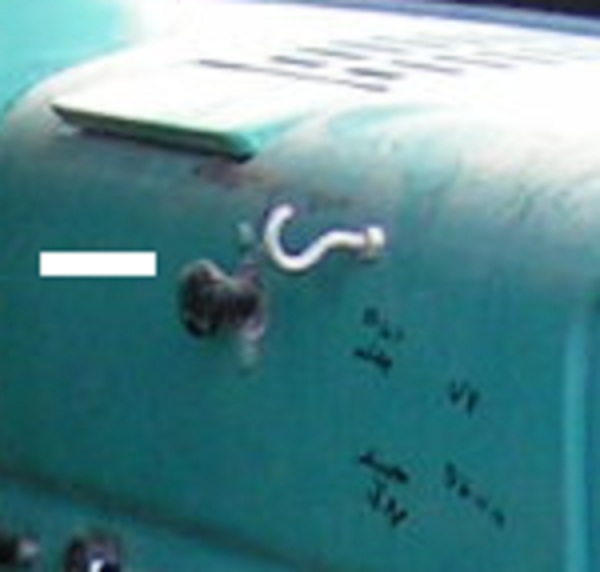

I had a 67 d500 dump truck that had dual saddle tanks. It had a valve on the floor and a switch on the dash for the gas gauge.It looked stock to me. The hook was aftermarket.

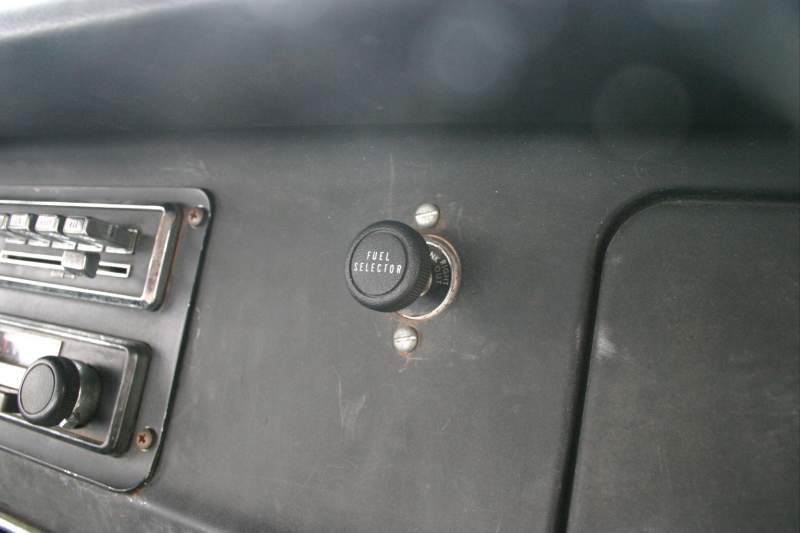

The original valve was cable operated from a knob on the dash, this is a Mopar part.
The switch on the dash was only for the gauge

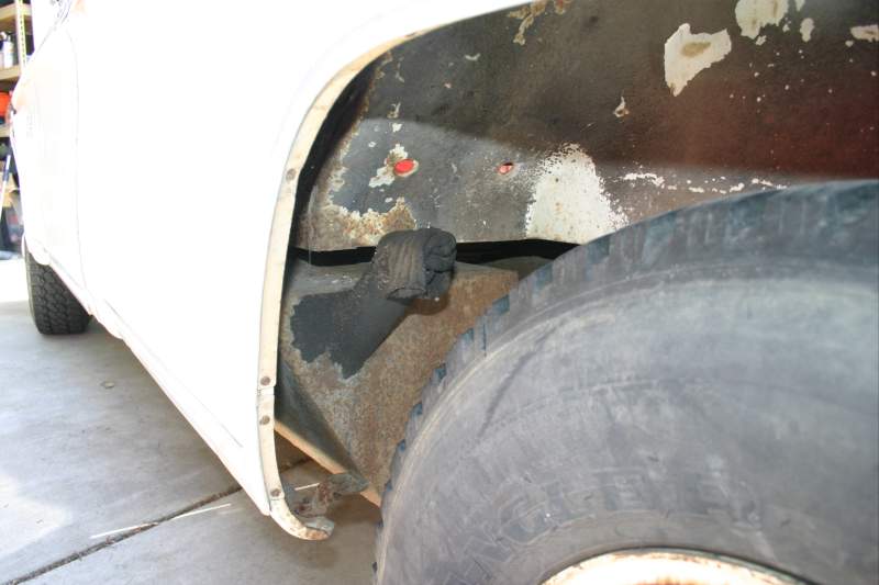

My tanks filled through the wheel well, obvious problems with this.
(These were not hooked up)
The floor selector was probably added when the cable broke.
Alan

digdoug, hang a modern Pepboys plastic cupholder on that hook and then you have old meets new :-) . Shaken(severely), not stirred
OHHH! you definitely can't buy that new ! (boy, does that fit these trucks)

Hello Dan,
That is the same set up I have in my '70 W-200.
In my truck, the center position on the floor valve = the tank behind the seat + left and right positions = left and right saddle tanks.
The switch on my dash is connected to the fuel gauge with the same positioning. Center position = center tank - left and right = left and right tanks.
