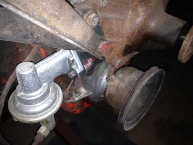

Re: timing mark 61 poly
Believe it is in the side of the pulley. Hole or mark hard to see ,but there. This is a 318 from a '62 dart.
mine has a harmonic balancer. just not seeing any line. I sanded the whole thing down too. I will get in there with a better light and try again.

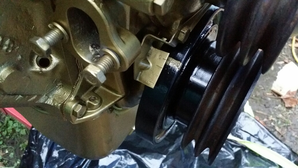

Posts: 1394
sorry it took me so long. been travelling and really busy. got engine dropped in. took this just before install. the 0 and the line are faint to I highlighted with engine color
That picture is with a damper , not the early pulley type. There should be a line on the damper, hard to see sometimes. Great looking color!

Txas2step wrote:That picture is with a damper , not the early pulley type. There should be a line on the damper, hard to see sometimes. Great looking color!
Thanks, that color was on some 61s. Golden Lion is what Chrysler called it. discontinued by Chrysler a few years ago. got some out of Canada. I like it. the engine is original 1961 and has the balancer. maybe because its a 1 ton? its not a 318-3. solid lifters and block stamping verified. R318 149867
