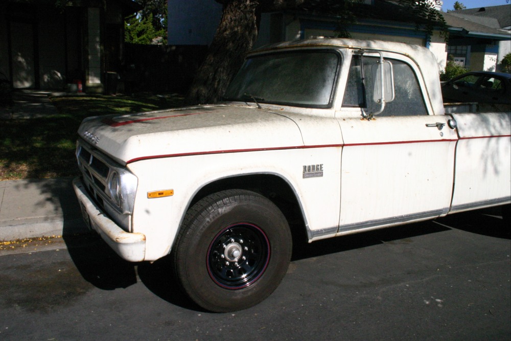

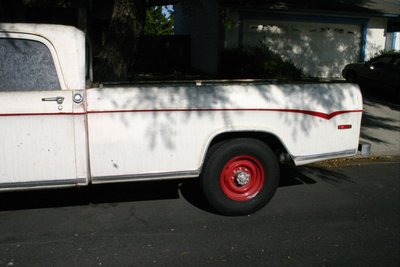

Well I guess the Scarebird conversion isn't for everybody. With the D200 you can not use factory wheels, I tried both the original split ring and the 72+ wheels both with problems. I tried a spacer but at 1/2" I didn't like it. For now I have a couple Cragers of the front while I look into different wheels. The other thing that I had a problem with was the rotor on the right rubbed the Scarebird bracket, no real control here as that is set by the inner bearing (probably should have been replaced). So for now I shimmed the rotor out so that it will clear.
Scraping after less than a mile of driving.
Shims in place
Shims in place
Front wheels
Front wheels
Rear wheels
Rear wheels
Both
Both
Not the look I was going for but at least I'm back on the road.
