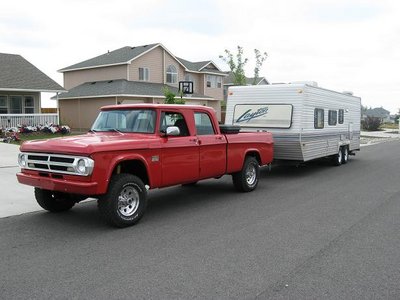

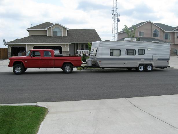

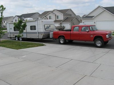

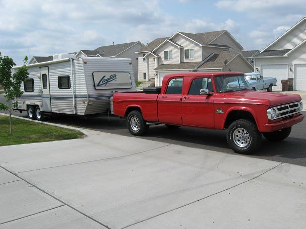

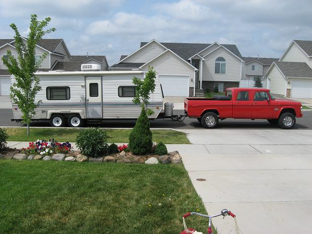

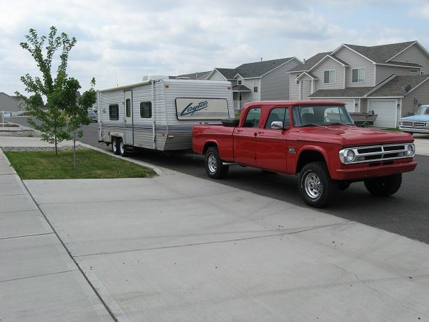

Finally set up elec. brakes in Sasquatch. Hooked up to the travel trailer for the first time and pulled about 25miles round trip. Pulled a nice steep grade on highway 395 north of Spokane. Sasquatch Pulles AWSOME. 55mph up the grade in 4th gear. I didn't think it would with the gears and tire size. I love the combo of 3.54's in the 92' axles, Springs & air bags (20psi), 33" tires, Power steeeing that I built, 440 and NP 435.
I even made a few stops without trailer brakes to see what it would do if I lost them. Stops Awsome. The big brakes are worth ever penny.
The trailer has 680lbs of tong weight with out being loaded with fresh water. The trailer weight is 4900 lbs not loaded.
I very happy with how Sasquatch Pulles and Rides.
next I'll try my heavy duty drop hitch instead od the equalizer hitch. The equalizer does not adjust low enough for the hight of my truck. The trailer pulls so nice behind Sasquatch, I really don't think it needs it. I have very little pressure on the bars. I may build a hitch for them because I do like the safety they provide.
