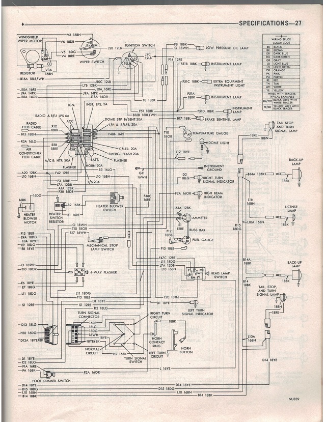

Hey folks, I've got a few things I'm asking for some help with. I noticed a few cut wires in the factory wiring harness under my hood the other day. I've looked over the very helpful threads from MrMopar, and I've traced down what I could but I'm still blank on these issues. Here's a few pictures of what I noticed was cut under the hood.
Info: 1970 D200 Camper Special regular cab. 318/3speed auto
First, I have a cut "RED" wire in a wiring harness. This harness is the set of wires running from the connection block located next to the brake booster on the firewall. The wiring then runs down the driver side fender, and the other "cut" end protrudes out of the wire wrapping. These are the 2 photos below. This wiring harness continues on to the front lights of the truck, running just up to the driver side of the radiator. I do not see any cut connections anywhere else on the block connectors on the firewall that this may have been part of.
Next, there is a "BLACK" wire cut which is part of the ballast resistor wiring harness. After tracking down this section, I have found the other end of this wire is running to the alternator, but it is simply twisted around a long threaded fastener on the top side of the alternator. There is also a larger gauge "Black" wire running off the ALT, but this wire runs directly through the firewall and I have traced it to the back side of the dash cluster. This is not what is shown in MrMopar's wiring images, so maybe there is some variations to the production dates and/or it's just changes unknown in the records.
The last thing I could do is really look over all 3 of the block connectors on the firewall, checking them against the wiring diagrams. To note, I do not have any issues that I've noticed so far. That is, all my lights work, and the relay I've added under the hood is all new for my fog lamps.
As a quick reference, here are the links to the wiring diagrams that have been really helpful!

Not a 100% sure, but those look like they might be your amp gauge wires. Those diagrams in that link you posted are not factory diagrams, thus why they're wrong or have mistakes. Those are some aftermarket diagrams, from a Chiltons, Motors or Haynes manual. The FSM has a lot more detail and they are correct.

Thanks Mark. I didn't know those other images were something aftermarket like Chiltons. Would you know if anyone has posted images of a FSM online somewhere? Or has anyone uploaded them to another website?

Those wires may be left over from an AMP gauge by-pass. Lookup Dodge gauge bypass MAD Electrical. Even if that's not what your looking at you'll find some good info on that web site.

John, that is the same exact diagram from mrmopar (I think he just copied them from sweptline.com)and they are incorrect diagrams. Those are some rendition of the original and half the info from the FSM diagrams are missing. Termination identification, wire size, wire name are missing and the wiper switch, headlight switch, directional switch, starter relay, hazard switch, among others don't even have the correct configuration for the wiring. I've seen those diagrams before and not to be negative, but they suck.

Good to know Mark. I figured they were direct copies out of the correspondingswptln wrote: ↑Fri Jul 12, 2019 1:07 pmJohn, that is the same exact diagram from mrmopar (I think he just copied them from sweptline.com)and they are incorrect diagrams. Those are some rendition of the original and half the info from the FSM diagrams are missing. Termination identification, wire size, wire name are missing and the wiper switch, headlight switch, directional switch, starter relay, hazard switch, among others don't even have the correct configuration for the wiring. I've seen those diagrams before and not to be negative, but they suck.
model year FSM. I'll have to see if I have a FSM newer than '69 so I can take a
look at the diagram....

This is a 1969 FSM wiring diagram. If you look, you'll see there is no comparison to the one's on sweptline.com.

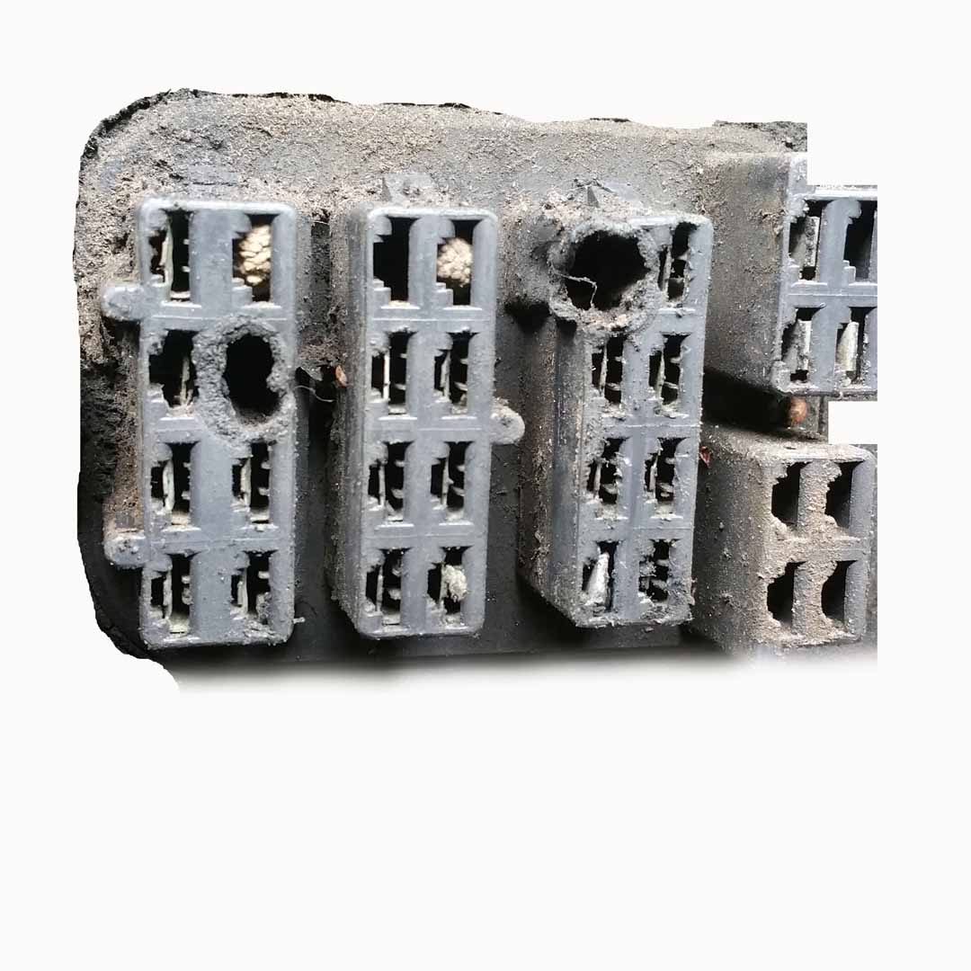

It was pretty common for the spade lugs on the alternator lines in and out of the dash to fry inside the bulkhead connector block, short to something, and then fry the wire (spade lugs are way too resistive for that much current). A pretty common fix was to run wires directly off the alternator through a drilled hole in the firewall to the ammeter and back to the starter relay. Most rarely used a decent grommet, and even if they did, they don't last long. So chances are that the mechanical protection for the wire insulation where it goes through the sheetmetal is inadequate. I plan to put a couple of 5/16" stud bulkhead connectors through the firewall for those high current lines.jacqueskruseo wrote: ↑Sun Jul 07, 2019 7:59 pmI noticed a few cut wires in the factory wiring harness under my hood the other day. I've looked over the very helpful threads from MrMopar, and I've traced down what I could but I'm still blank on these issues.

The problem is not the spade connector, it's the wire itself. You have a system capable of putting out 37-60 amps and Dodge only used a 12AWG wire for the ammeter that only has TW insulation good for 20 amps continuously. Those spade connectors are good for 30 amps continuous.........the system is designed to handle the full load for only a short period of time and if everything is working properly the amperage is supposed to decrease in a short period of time.Wildergarten wrote: ↑Sun Jul 14, 2019 3:20 pmIt was pretty common for the spade lugs on the alternator lines in and out of the dash to fry inside the bulkhead connector block, short to something, and then fry the wire (spade lugs are way too resistive for that much current). A pretty common fix was to run wires directly off the alternator through a drilled hole in the firewall to the ammeter and back to the starter relay. Most rarely used a decent grommet, and even if they did, they don't last long. So chances are that the mechanical protection for the wire insulation where it goes through the sheetmetal is inadequate. I plan to put a couple of 5/16" stud bulkhead connectors through the firewall for those high current lines.jacqueskruseo wrote: ↑Sun Jul 07, 2019 7:59 pmI noticed a few cut wires in the factory wiring harness under my hood the other day. I've looked over the very helpful threads from MrMopar, and I've traced down what I could but I'm still blank on these issues.
Then you have the vehicle owner or aftermarket installer factor that adds all kinds of auxiliary equipment on the load side of the ammeter circuit instead of installing a secondary circuit from the battery to handle the load properly. This is why they manufacture relays, but nobody want's to use them, until they start burning up wires and terminations.
The best thing you could do for a normal system on our trucks is to upgrade that 12AWG wire to a 10AWG with a higher class temperature insulation to handle more of a load for a short period of time. Automotive wiring has the lowest class temperature rating of all insulations (TW) for wiring, it's just a low smoke class of insulation.

Oh I think the problems started LONG before that, with the first time somebody left the headlights on and got a jump. It's a major design deficiency. Below is the connector from my '69 W200. The wire was fine. The connector block can't get rid of heat efficiently. Wish I could get a newer one as they work great for all but the two high current lines.
