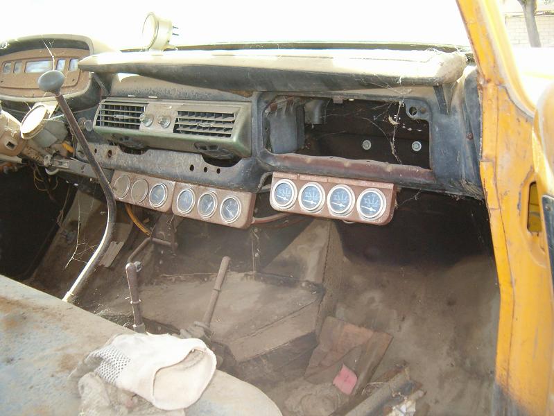

If this helps here is how the A/C was installed in my truck when I bought it. It didn't work so out it went.

Hey Mikemc....what on Earth were all them gauges reading? I've never seen that many!

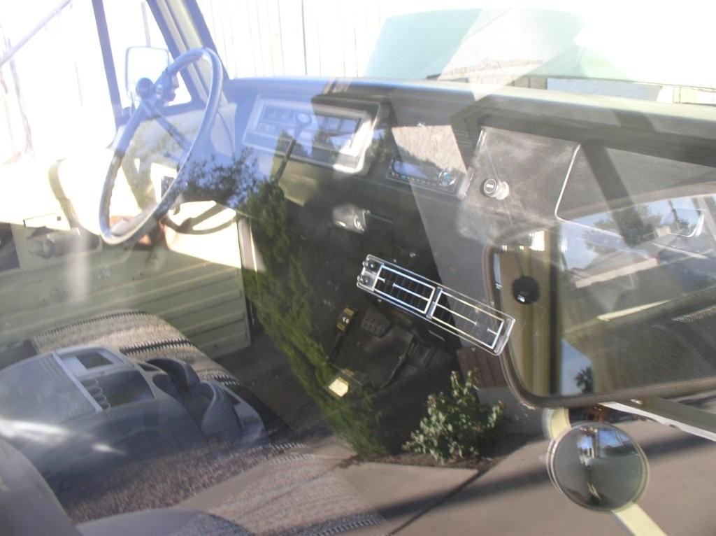

I used the after market under the dash unit since
I wanted that "ole time look" ( more of these
were sold than original A/C optioned Trk's ).

Re: A/C for our trucks
me neither!BrowneBlue wrote:Hey Mikemc....what on Earth were all them gauges reading? I've never seen that many!
Just a wanna be big rig LoL
I ain't seen that many either but I'm working on putting them all back in.

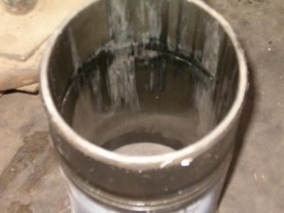

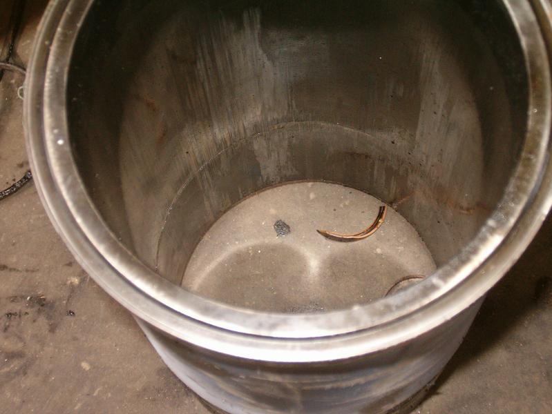

And if you keep the exhaust temp that high for too long you can melt a hole right in the piston, which is more fun than the scored liner walls you pictured.
