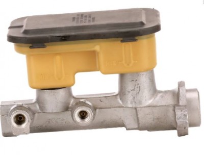

The main problem with the earlier Scarebird package (that most of us appear to have), is the use of the GM "low-drag" calipers. This was a design that GM came up with that would cause the pads to retract further away from the disc at rest so as to avoid drag. This was mainly done as a fuel mileage benefit. What was never communicated in using this caliper assembly in an aftermarket application is that the correct master cylinder needs to be used, not just in terms of diameter but more importantly of the correct bore design. A master cylinder designed for the GM low-drag caliper requires a "take-up" cylinder that has a larger diameter step in the bore, created to allow more volume at the initial press of the brake pedal in order to get the pads to move out quickly and meet the disc. Once the pads have med the disc, the master cylinder piston is in the 2nd (smaller) diameter section of the bore and functions normally at that point.
If anyone is wanting to change to a "take-up" master cylinder, an 80s S-10 a match for these calipers.

Are there other vehicles Chevy used this “take up” master cylinder on?Series1Utiline wrote: ↑Fri Feb 10, 2023 7:22 amIt would be nice to be able to get some specs on the new brackets but as mentioned, that would likely only happen when someone is able to get a set and copy them. I wasn't even aware they had come out with a 2nd design that used other caliper assemblies.
The master cylinder and booster I used was from a 93 camaro. And I used an adjustable pressure regulator for the rear discs. The truck stops better than any 60s era vehicles I have driven.

Yes there are others although I'm not clear on what other models and years. You can often tell by the external appearance as in the picture below. The cylinder is larger at the firewall (flange) end which is the "take-up" volume.

Wild, I didn't know that about the master cylinder. Would explain part of why I always felt the travel was way too far for these brakes. I nearly bought a MC with a larger bore diameter. Not that it is the same as a take up master cylinder, but might have helped.Series1Utiline wrote: ↑Fri Feb 10, 2023 7:22 amIt would be nice to be able to get some specs on the new brackets but as mentioned, that would likely only happen when someone is able to get a set and copy them. I wasn't even aware they had come out with a 2nd design that used other caliper assemblies.
The "metric" caliper has a smaller swept area for the pad. So, in some ways, I'm not totally disappointed that I've got the older setup. The option for a 4 piston Willwood caliper, on the other hand, would have been great.
