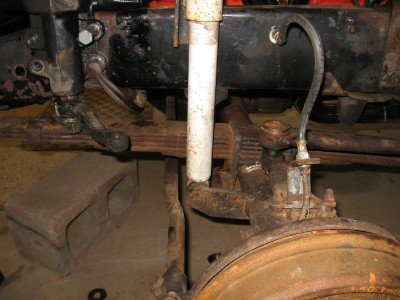

Here are a few photos of what's done so far:

Nice! That box is laid out the same as the IFS Toyota boxes, which I had thought
would be excellent for cross over steering.

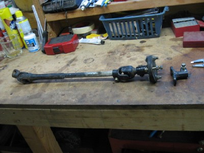

I did some more digging today and found a rag joint/u-joint combo. off of a Toyota 4Runner that will bring the rear of the shaft up to an acceptable position. I'll keep the flange on the column shaft and file out the bolt holes by about 1/8" on each side. All I need to find now is a long enough section of 11/16" (17.5mm) shaft.
I could buy all the u joints, shaft, etc. I need from Borgeson but I'm trying to do this all with junkyard parts, with the following goals in mind:

The box is now bolted in; as mentioned earlier I used the upper shock mount hole as my datum point. The sector shaft was set up as close to vertical as possible. This puts the pitman arm and steering arm arcs on as close to the same horizontal plane as possible to maximize pitman arm travel. I used 1/2-24 grade 8 bolts and nylocks. I ran a 31/64ths drill through the holes in the box, and on through the frame, to have a nice snug fit for the bolts.
The shock mount will be relocated 3 1/2" rearward from its original location, at the same elevation and angle.

I also have the Toyota flex coupling/u-joint attached to the column shaft. I took photos of what's been done but I'm too blasted tired to post them tonight.

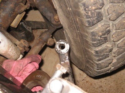

I still need to find a couple of tie rod ends with the same taper angle as the stock Dodge drag link, and with 3/4-16 RH thread, for the new drag link. If anyone has a part number for these I'd sure appreciate it; that would save me a lot of hunting time.

On a 67 d300 tie rod end,the tapered end is right, but the threaded end is more like 5/8 or 11/16 .

Right on that; I'm looking for tie rod ends with the same taper on the stud as original, but with 3/4-16 thread, as I intend to use 1"x.1875" wall DOM tubing. Thanks!digdoug wrote:On a 67 d300 tie rod end,the tapered end is right, but the threaded end is more like 5/8 or 11/16 .
By the way, where did you find the reamer you used?

Got it off ebay . A company called XKUT , part #5952.
http://stores.ebay.com/XKUT
It looks like they have some nicer ones than I bought for $20 more.Ive reemed @ a half dozen holes and mine is still like new.You would get less chance of chatter with the spiral one...
