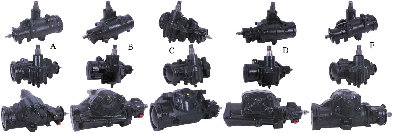

I have been hitting the yards a lot lately searching for stuff as my project
has progressed. I am now on the Power Steering phase. During this weeks
adventures I noticed a couple things about steering boxes - There seems
to be several over qualified donors, including one that looks to be better
than the Ford and even one from a Dodge!!
Got yer attention yet?!
I present here 5 boxes, from Dodge, Ford and Chevy.
Take a second to review them, and I will identify them in the next post.
(Pay close attention to the one in the middle.)
Click to Enlarge

If you look close, the 2 on each end are nearly identical, with the exception of a few
minor bosses or shapes of plates. But the 3 mounting holes are all in the same place.
The inputs and out puts appear to be the same on all 5.
If you pay extra close attention, you will notice that the one in the middle has 4 holes
clocked 90 degrees from the others. If it were mounted in a Sweptline, the 4 holes
would be facing DOWN!
OK, enough waiting. Here the descriptions:
A
Dodge Van 1994-1998
Chevy Express/GMC Savana 2500/3500 1996-2002
B
Ford Bronco 1980-1996
Ford Bronco II 1984-1990
Ford Econoline 1982-1996
Ford Explorer 1991-1994
Ford F Series 1980-1996 & 1997 F250/350
Ford Ranger 1983-1997
Mazda B Series 1994-1997
Mazda Navajo 1991-1994
C
Chevy Blazer 1980-1982
Chevy C Series 1980-1986
Chevy/GMC R Series Truck 1987-1989
Chevy/GMC R Series Suburban 1987-1991
GMC C Series 1980-1986
GMC Jimmy 1980-1982 & 1987
D
Ford Expedition 2001-2002
Ford F150 1997-2004
Ford F250 1997-1999
E
Chevy Blazer 1992-1994
Chevy/GMC C&K 1500/2500 Series Truck 1988-1995
Chevy?GMC C&K Series Suburban 1992-1995
Chevy Tahoe 1995
GMC Yukon 1992-1995

Now there are a couple unknowns.
Even though the inputs and outputs look the same, are they actually splined the same?
I am going to try and do some more checking on my next trip to the yard.
Also, how do the ratios and number of turns from lock to lock compare?
My guess is that the ratios are pretty close considering the vehicles are
all pretty similar in size and weight. Splines could be an issue, based on brand.
As a side note: The Dodge vans use a double U joint linkage to connect the
box to the column. The column end is a Double D. This could prove helpful
if you needed help lining things up.
I am all ears for input on these!! I picked up a 96 Ford box yesterday, but that
Chevy box with the mounts on the bottom might make mounting much easier.

The 3 boxes: 95 Ford, 84 Chevy, Stock 70 Dodge.

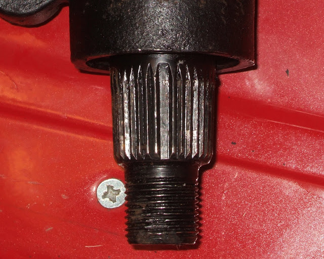

Up close - Ford
Chevy
Stock Dodge
The input shafts on the Ford and Chevy were a different tooth count, but
the outputs were the same. The Ford pitman fit on the Chevy box with
only one issue. The splines flared out at the back on the Ford, the Chevy
maintained the same angle. So the pitman slide back further on the Chevy.
However the thick lock nut easily tuck up the extra space.
Ford
Chevy
Next I test fit them. They both are very tight to my exhaust.
When I drop the column in, it sets right on the box! This shows another
problem, the column is on the box, which I have heard needs cut back,
however the shift arm is touching the firewall. So cutting wouldn't
help any, unless I made a bent shift arm.
Here is the Chevy
While is doesn't make things any different at the firewall, it does offer
a little more space at the exhaust. However, this thing will be a dream
to mount!
The Chevy box has a little more room for the fittings also, but not much!
The lines will need to do a quick 180 and run in under the box and around
the outside. A large oil cooler should help deal with the lines being so close
to the exhaust.
As I mentioned, this Chevy box is very close and looks identical to the boxes
used on the 72-79 Dodge trucks. The Dodges break 72-77 and 78-79 for some
reason. They are available in Reverse Rotation, were I haven't found any other
boxes of this design available in reverse rotation. O'Rielly says they can get
me one for $165 with a lifetime warranty. I am VERY tempted to go ahead
and order it. However, I would still like to be further away from the exhaust.
So I am going to make one last ditch effort to source a Toyota box cheaply.
