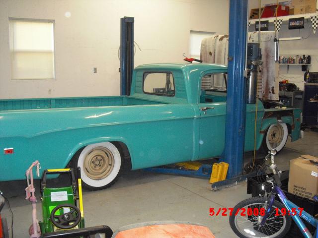

here's a pic of mine, i've got 1 leaf out of each spring pak,
but my truck is currently tore all apart, i want it much lower, without losing any ride quality.
matt

I've followed the lowering posts over the last year or so. What you are proposing, I am currently in the middle of. I flipped both front and rear axles. I removed enough springs so that the front one is basically flat and the rear has little arch. I sent the front axle to Sid at dropped axles in Oklahoma. With the axle on top of the spring, you can only drop it 3" or you'll be pushin the springs thru the yard. Some of the problems encountered are bump steer and oil pan clearance. The only way to correct the bumpsteer is to put the drag link back into its original arch of travel. I did this by shortening the pitman by 1", moving the box up by about 1", and bending the steering arm down until the drag link just barely passes over the axle. If you avoid this issue as I did when I first lowered the truck, it will be unsafe to drive at almost any speed over 30 mph. It will take the wheel from your hand when you crest a hill. For oil pan clearance I notched the /6 oil pan and welded a baffle on the inside so that flow from back to sump area is unaffected. With the drop completed, the body lines, and the high cut of the front fender lip, gave the appearance that the truck was lower in the rear, even though a level showed a slight rake. So I am now in the process of dropping the front fender lips 3" to give the appearence of a lower front end. Right now with air shocks on all four corners, and just a little air, I've got 2.5-3" of clearance between the oil pan/axle, the top of tire/inner fender, and the u-bolts/frame, on the front. In the back I've got slightly more. But I would say that with out major surgery like SLICK is undergoing, this is about as low as I can get it

i luv what you did to the frt fender lip!!! thats gonna be slick when its in color! by the way looks good & low!
