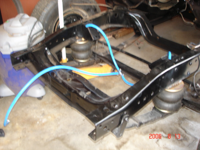

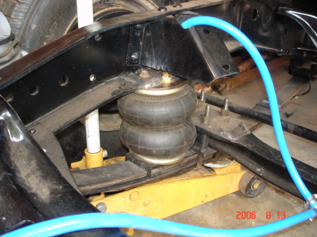

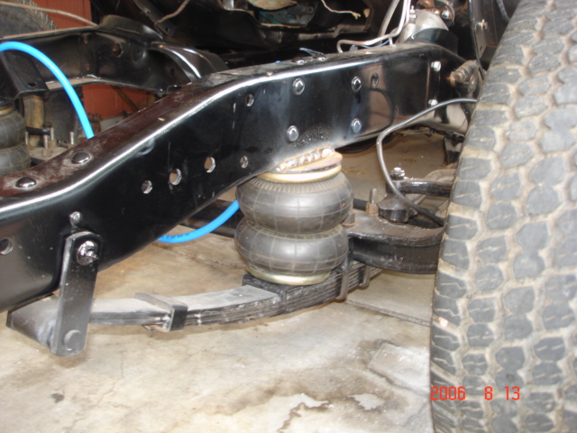

Personally I think the easy way to avoid the bumpsteer issue is to bag the straight axle. I was going to do it, but deciced not to at the last minute
that way you can lower it when you are just cruising or parked then air it up when you are driving

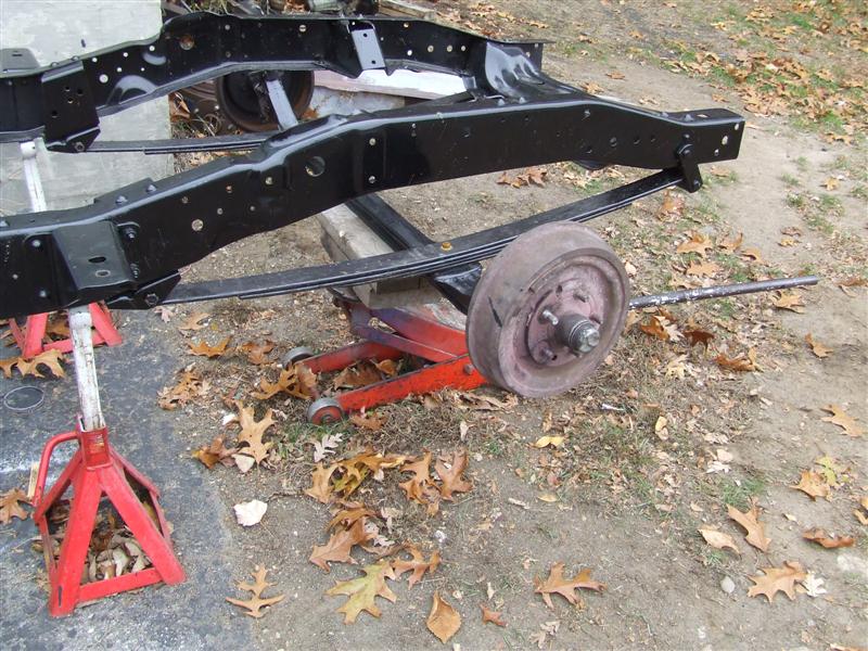

I FOUND THE BEST WAY IS TO GET 4X4 FRONT SPRINGS AND THEY ARE FLAT ... FITS RIGHT IN....
DRIVE A HYBRID,, MORE GAS FOR ME !!! http://www.youtube.com/watch?v=lOhABpUFumk
Re: lowering
You are exactly right, 4x4 springs will drop them, for their isn't any arch to the 4x4 spring, isn't it also a thicker metal spring???? I'm going with them also droping it down further

no the factory packs are the same, the differance is the 4x4 springs have no arch because the axle sits below the spring, the same effect can be done by taking the existing springs off and go to spring company they will de-arch the springs for $30, if you take it in for them to take off the springs then add $180 per side, so its more cost effective to get 4x4 springs and put them on, especially for me because the thicker metal springs can take more of a "G" force

I just pulled a couple of springs..It only aired up about 4 inches. It could actually go a couple inches lower, but I hadn't cut my u-bolts off and they were hitting the frame..

WHAT I DID WAS TAKE THE MAIN LEAF FROM THE 4X4 AND USE THE LOWER SPRINGS FROM THE STOCK SPRINGS ... IT MAKES IT ARCH JUST RIGHT ......
