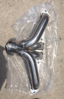

I bought stainless headers on ebay for my 383 dna motoring .com

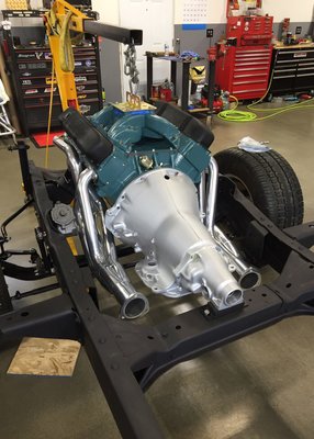

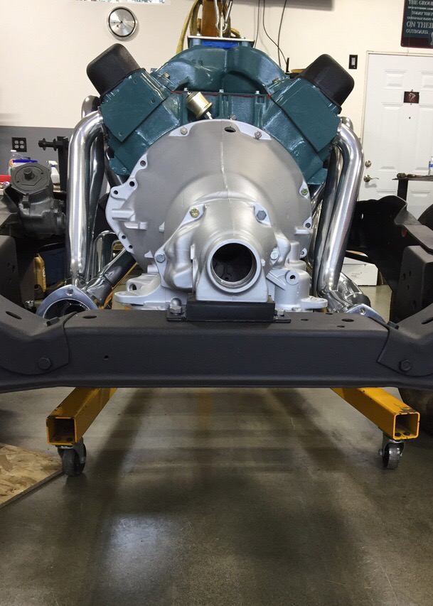

Here you go. Everything fits well. Header collectors will have to be cut back as far as they can, angled down slightly, and scallop a bend down then back level to go under transmission crossmember. Just finished the engine enough to install in frame. 727 cases are empty and installed for mock up.
