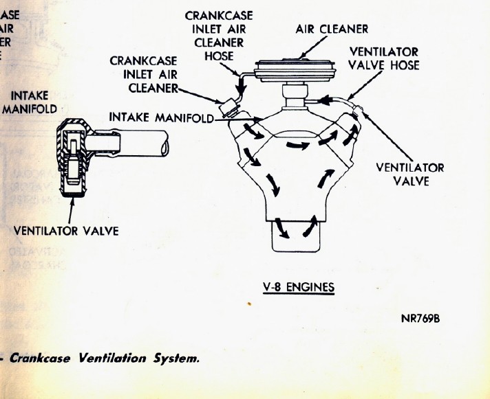

my 360 is blowing oil out of my dipstick tube. i have two oil breather caps that connect to a tee and go to the back of my carb. yet she still blows oil. what configurations do you guys use and have you ever had to deal with this same issue? its not continuous, just once i get cruising at high way speeds

PVC on one valve cover to carb, breather on the other valve cover without vacuum, open. Not saying that's your problem, is it like puking out oil or just dribbling down the tube?

No need to get a new PVC valve, soak it with solvent so the check ball inside moves and just soak your breather also. It sounds more than just that, a compression check will give a more definitive answer. A leak down test would be better.

Aerosol brake cleaner, acetone, or go old school and use gas.

If they're new and clean, you're good. White or blue-tinted smoke from the exhaust?
