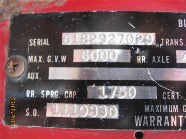

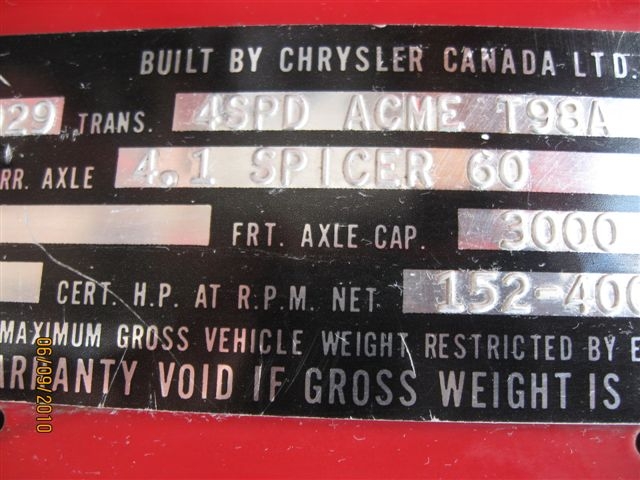

Not sure what year the donor truck is digdoug...early sixties judging by the quad headlamps, I was suprised as well when I saw this on the data plate soopernaut, hence the query to the forum, I'm hoping the diffs have some good stuff hidden under all that grease. I will capture an image of the data plate for your review and comments fellas hopefully with some help I can decode this unsual data plate.

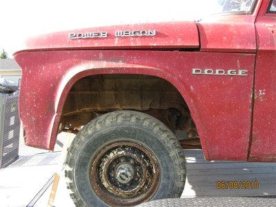

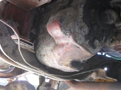

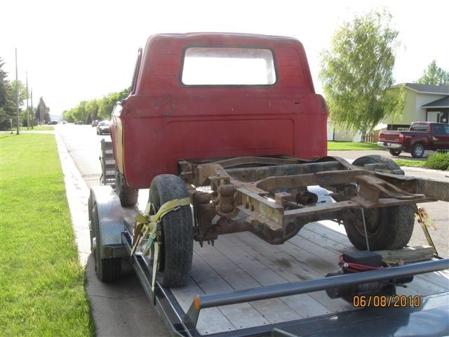

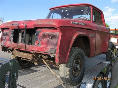

0k fellas, here is the data plate images and a couple additional...not sure of the year ? I know it is a W100 since it is short wheel base. Please offer your comments on this particular tranny. A side note this truck has the E- brake on the T-Case same as both my W300's. jwing68

That truck looks like a 64 or later w100. Very cool...I have never seen that tranny in a dodge before... What did it use to have for a bed? Was it a brush truck?
Here is a little info from Novac...http://www.novak-adapt.com/knowledge/t98.htm

Thank's digdoug :salut that Novak link is very informative...I am very pleased by this info, sounds like this Borg Warner T98A is a great candidate to transplant into my W300 and by all accounts it is a cut above the NP 435 that is so common. I can hardly wait to get it out for verification! Why do you think Chrysler calls it an "Acme" when in reality it is a Borg Warner ? I have very little history on the truck, a Hutterite colony near my location has used it for the last 20+ years as a mule to haul around an 80 KW Kohler power plant. The last 7 years it has sat dormant and been shot up a bit. I will dig a bit deeper on the history and see what kind of story surfaces.
