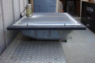

Here is a pic of the tank and a frame I made out of 1" square steel tubing and 2" angle iron to support it.
Plan is to hang tank and frame from the frame rails using 1/8" by 3" steel flat bar stock.
Shouldnt go anywhere.
Also, while I was at it, I found a Dodge decal that fits my tailgate very well and put it on.
Tim
Re: Rear underbed gas tank conversion
Looking good!
How far below the rails or above the ground will it be?
Where did you decide to put the filler?
I'd like to see the "installed" pictures when you get time.
Pat
Pat

The top curvature of the tank fits the rear crossmember almost perfectly, but the tank hangs down too low in my opinion.
I plan to move the crossmember back about 4 inches from its current location. That will allow me to raise the tank another 3-4". Gett at the rivets to move that thing is going to be a PITA. Will likely have to pull the bed boards above the upper ones to get at them.
Figuring out where to put the filler on a Ute is a bit tough. My plan for the filler is to install a flush mount stainless marine style filler in the top of the drivers side rear fender and run the filler pipe/hose from there through/under the inner fender/bed bottom.
That was one of the reasons I picked the Bronco tank. Has a center, drivers side fill connection.
