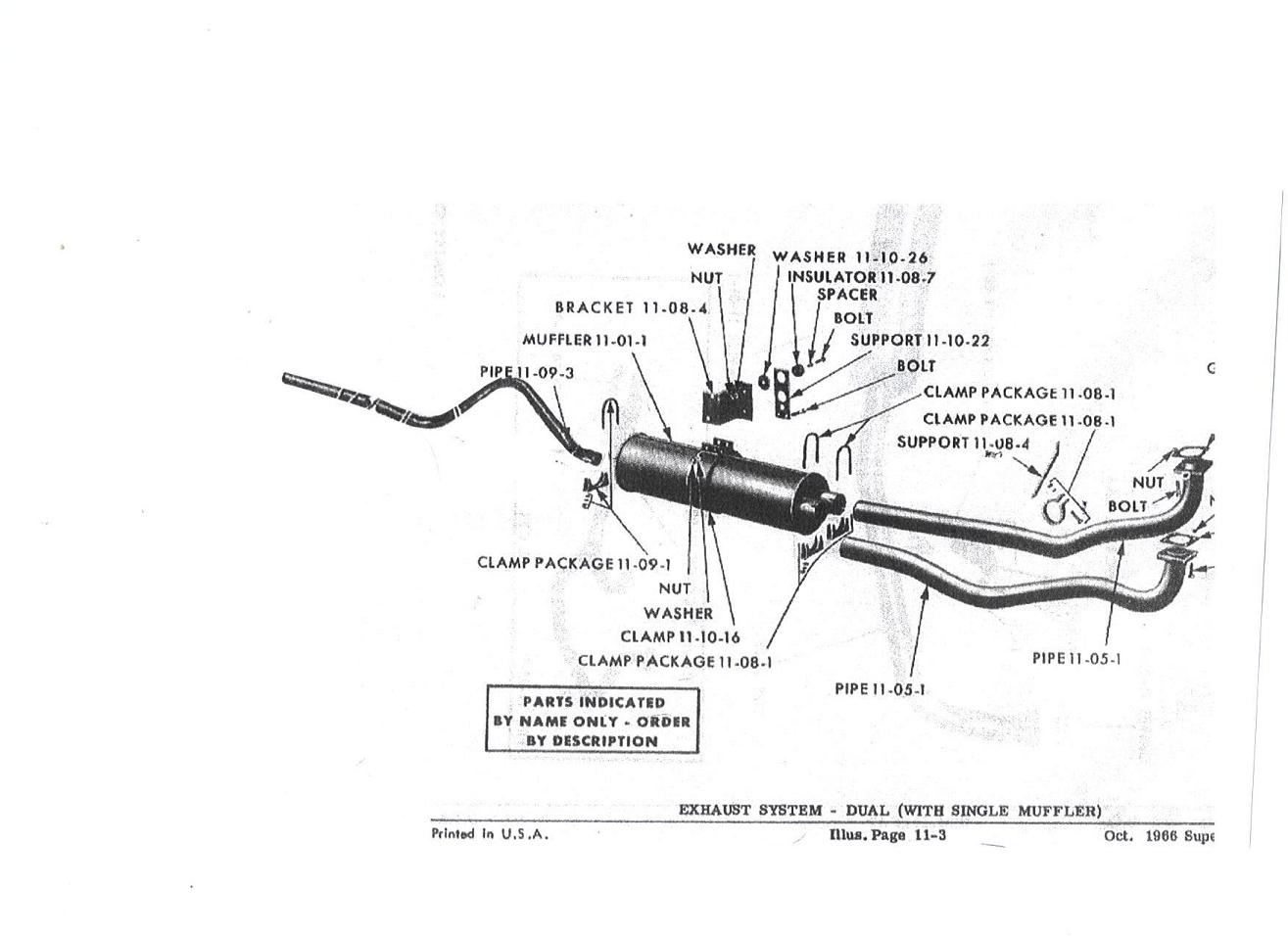

There is a way of getting better HP, Torque and Fuel Economy than what your A-318 engine came with.
Use NAPA's # 22599 muffler with the exhaust design attached below and your original exhaust manifolds.

Re: Eddy Performer or Performer RPM for a Poly318?
There is a LOT better way than running that exhaust system, buy a set of the DTA Poly Headers....asDieter has already done...= )
