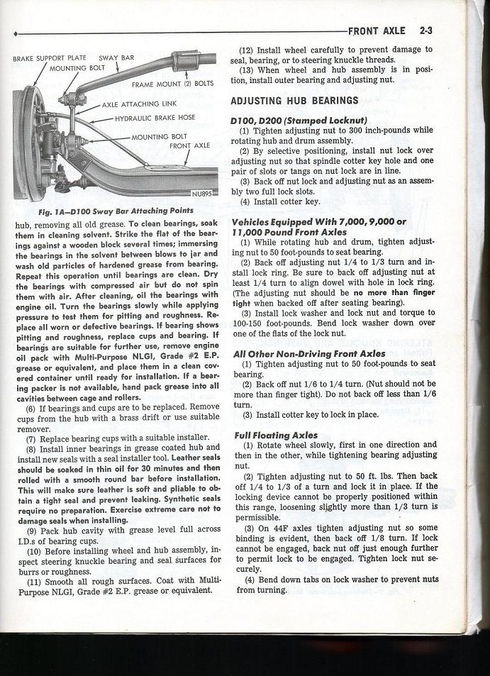

whats the proper way to adjust the front wheel bearings on a 70 w 200 with a dana 44? i need the torque settings too.
i cant find anything in my books.

hi am am also looking for the answer to this question if anyone has the info. i dont have a service manual and its for a 68 W200.
my locking hubs quit working and i traced it back to the wheel bearings being completely worn out on one side about 3/8ths of play, which i was shocked because it wasnt howling that loud.
i believe they wore out so bad because the previous owner just tightened the adjusting nut with a chisel and didnt get the proper torque on it. im ordering some new bearings tommorow hopefully there not to pricey.

Hers a clip from my 70 service manual.
