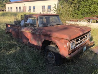

Going to look at a Power Wagon my uncle wants to give me for free as a project.
1969 Dodge W200 Power Wagon
Utiline bed
225 Slant 6
4spd Manual (NP435?)
US Army property tag on glove box
The bad: It’s been in Alaska, the California desert, Colorado, and finally north Texas. It has been sitting in his back yard since 1992.
Since I’m getting it for free, and have realistic expectations about how it will drive, I’m fine with putting up to $2-3000 in it over a years time in parts to get it running safely. I don’t care too much about aesthetics, but I want it to be safe. I can buy parts wholesale and can do 99% of the mechanical repairs it will need myself.
Is this a rare truck that’s obviously worth some sort of preservation and restoration? Or a run of the mill Dodge pickup?
Here are pictures taken of the truck back in 1986. I’m sure it doesn’t look quite so good anymore. Hopefully I’ll get to go see it in person in 2 weeks.
Utiline bed
225 Slant 6

I think all the sweptlines and utilines (which is what your uncle has) are worth saving, minus the trucks that are truly rusted beyond repair. You definitely don't see as many utilines running around as the sweptlines, so that is definitely cool.
You're not going to win any races, the slant six was pretty low geared to get that much truck moving under its own power. Are you planning on fixing it up and keeping it in the family long term? Definitely worth the investment. If you're looking at it to fix and flip, depending on its condition you probably won't make a lot of profit off it.
Get it running and safe, and have fun putzing around!

Welcome. Free is a good starting point.
If it isn't rusted into a heap and is pretty much all complete and original, I'd
say go for it. Fix it up and enjoy it. As far as rarity.... Its a 50 year old
truck that they don't make anymore..... and every time a Sweptline gets
scrapped/crushed.... it makes them all just a tad bit more scarce. These
trucks are pretty easy to work on too.... especially if you're already
mechanically inclined. Get some pics of it in its current state.

Well I went to look at it yesterday and do some work on it. The good news is that the engine wasn’t seized and I actually got it to start and run for about 30 seconds, but we shut her down since we didn’t have any coolant in it and the radiator was leaking. We silver soldered they leak and it should be decent for today’s efforts.
The goal is to get it out of the ruts it has sunk into after 27 years of sitting so I can come pick it up with the car hauler trailer next weekend.
https://imgur.com/a/qc8LJoi

Whew, another long day.
The truck runs, pretty well actually. But it seems like the clutch is rusted to the flywheel. Pressing the clutch all the way in still results in grinding trying to get in gear. We had a stuck wheel/drum assembly in the front which required practically destroying the drum to get it off. And the rear u bolts were rusted pretty bad and broke, causing the axle to shift sideways and tilt, which caused the u joint strap to give way.
I’ll be coming back to the truck next weekend most likely, or at least sometime in the next few weeks, with a new u joint (one of the caps on the old one broke, may just steal the cap from it), a set of 4 u bolts, and a u joint strap kit. Should be able to drive it out after that.
I’m think the drum brakes and clutch situation are going to be a couple days of work, but I just want it out of the field and on my driveway so I don’t have to make a 2 hour trip one way to do anything with it.

Unless you intend to replace the yoke (sometimes a very good idea), don't lose that strap!! They're very hard to replace.Specwar762 wrote: ↑Sun Oct 13, 2019 9:00 pmWhew, another long day.

I believe one of them broke. There is only one strap left on the axle. Until we can move the truck, I won’t know if it’s on the ground underneath it.Wildergarten wrote: ↑Sun Oct 13, 2019 9:05 pmUnless you intend to replace the yoke (sometimes a very good idea), don't lose that strap!! They're very hard to replace.Specwar762 wrote: ↑Sun Oct 13, 2019 9:00 pmWhew, another long day.
Is it not just one of the standard u joint straps that Dorman sells?
